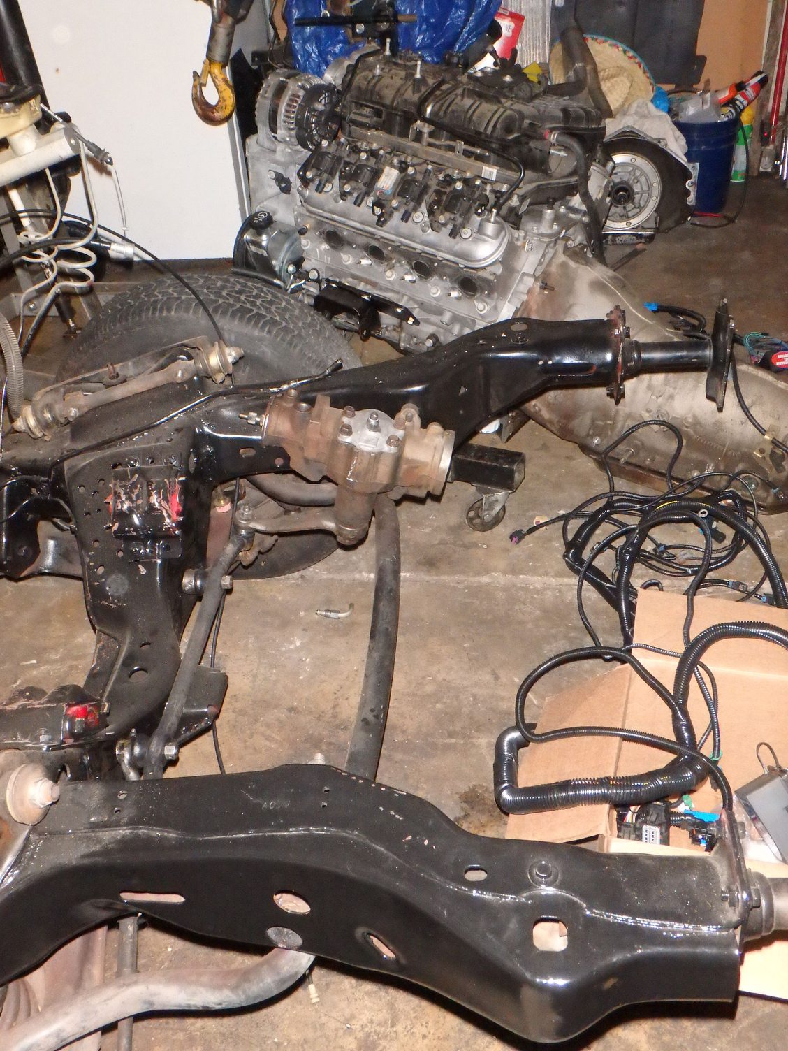

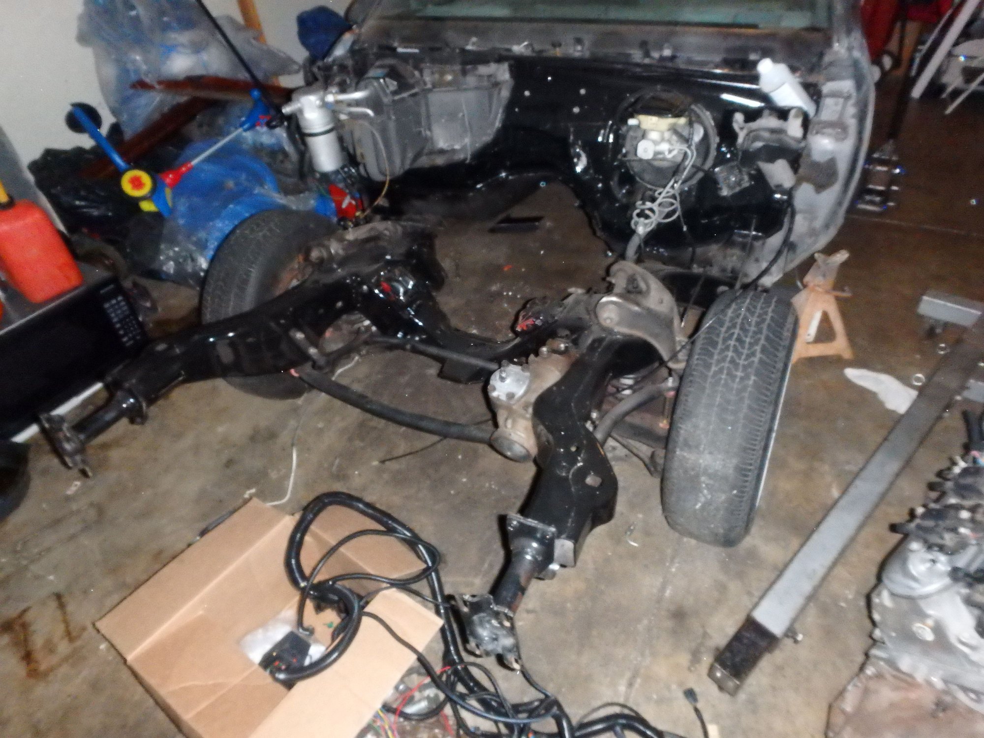

Those photos remind me of the current condition of my Monte Carlo SS.
i wish my was as clean as yours lol. the garage too
Old Jan 2, 2016 | 11:48 AM
  #1509
upflying's Avatar
Joined: Oct 2015
Posts: 89
From: Northern Idaho
That's epoxy on the garage floor. Thanks for the compliment, the LS3 should arrive truck freight next week. All Hooker-Holley conversion components. Just fiddling with the GN gas tank and sender in the meantime.
