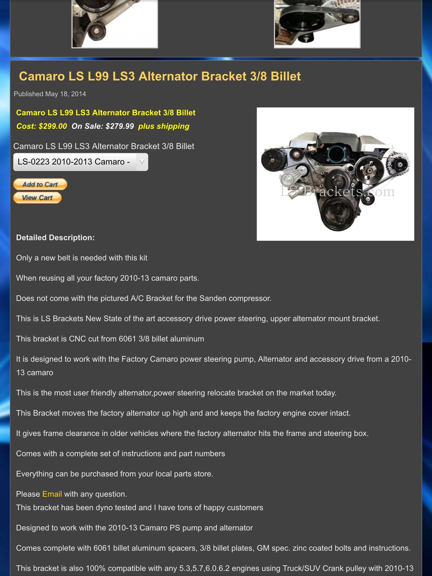

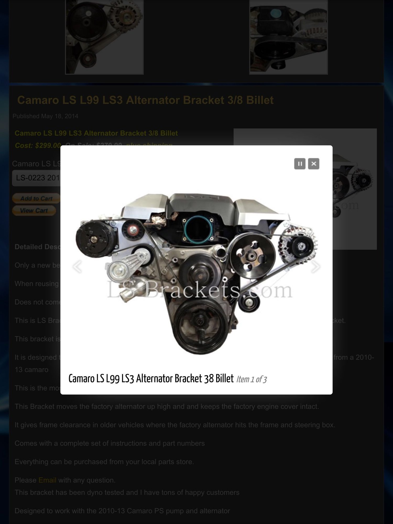

James, this should work on your swap. It relocates the alt and uses 2010 camaro accessorys . For the Ac you need to put it down low on drivers side like the gm trucks.google is your friend
What's up jimmyg, that looks like a good option for guys using LS3/L99 engines in their swaps...did you go that route with your car?

Hi Todd, I'm thinking of going this route when I install a whipple 2.9 over the winter. The whipple is set up for 5 th gen camaro accessorys , so it will simplify things if I do.
