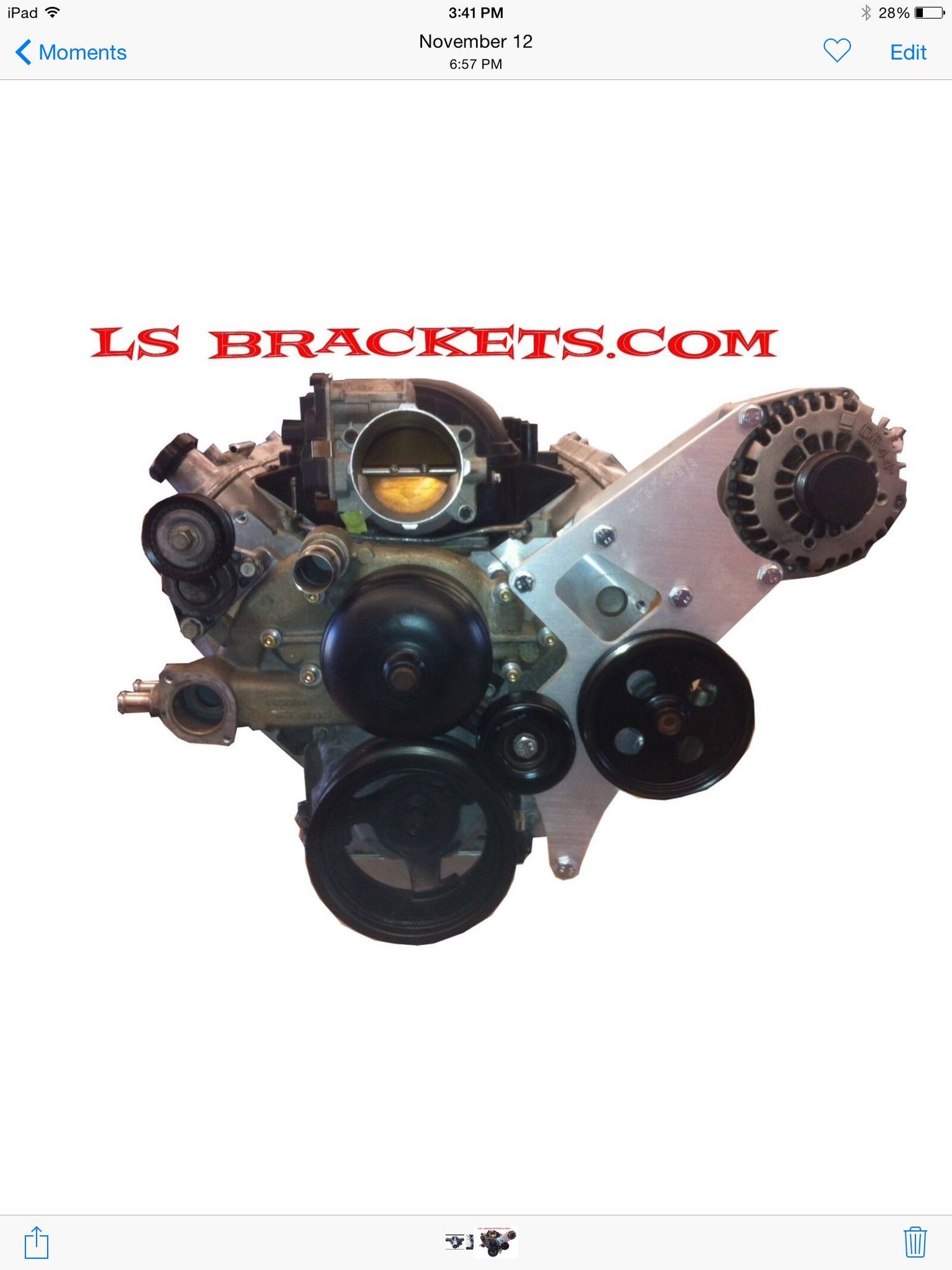

Old Dec 2, 2015 | 02:53 PM

I think you will run into problems using that bracket with the hooker mounts. I was told by someone who works for holley that the bracket won't work in truck spacing . the pulley will hit the ps hoses . U might be able to use low profile fittings to get around this. All the gen 4 blocks are the same when it comes to front accesorys you can run any ls front accesory u want . Corvette, truck, f body , ctsv, etc I am planning a whipple 2.9 install on my cutlass, so I have researched this extensively . Your cheapest way out is this bracket you can use a chevy truck ps pump, it won't hit the box, and is the same spacing as camaro this is the route I am going to take.

The ls brackets.com one will work because it moves the alt over for the blower but keeps the ps pump in the same location as the truck bracket which is proven to work with the hooker mounts. I know this because I'm using the truck brackets with the hooker mounts on my car. The 2010 + Camaro water pump and the truck pump are different but use the same spacing I'm using the camaro wp on my swap. If I were you I would return the holley alt bracket, buy the ls bracket and get a ps pump for a 2001 + gm truck your ps lines will bolt right up. I fig this out after hrs of research . I am trying to spare you the same. I am getting ready to put a whipple 2.9 on my ls swapped cutlass. The whipple and the Maggie you have are very similar

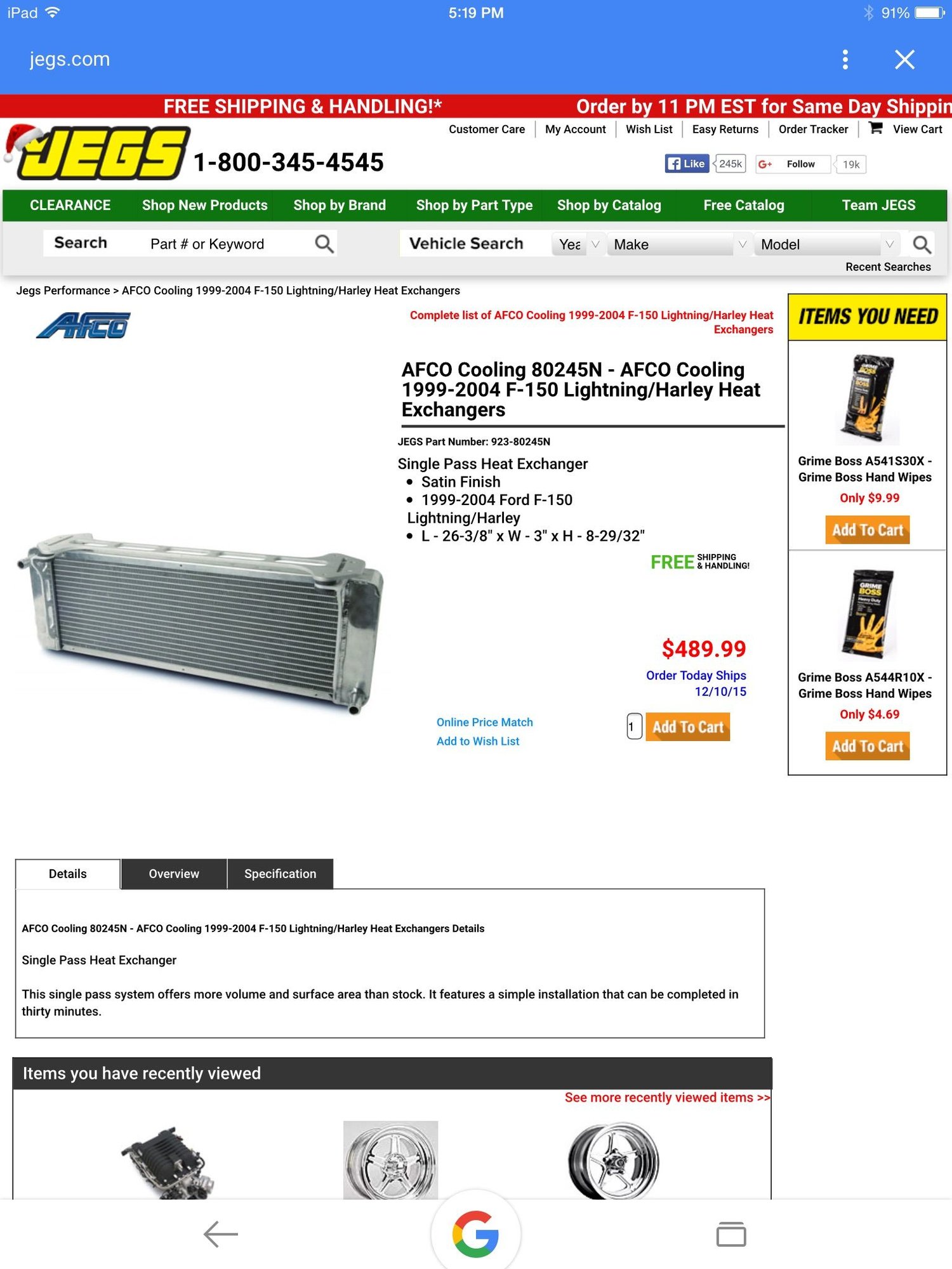

I bet you could use this

yes i did contact them and it was 500 bucks or more and i like it but i actually want a larger one as it heat soaked fast in the camaro but that lightning one looks like a good chioce ill do some measurements to find out thats a ways down the road anyways haha

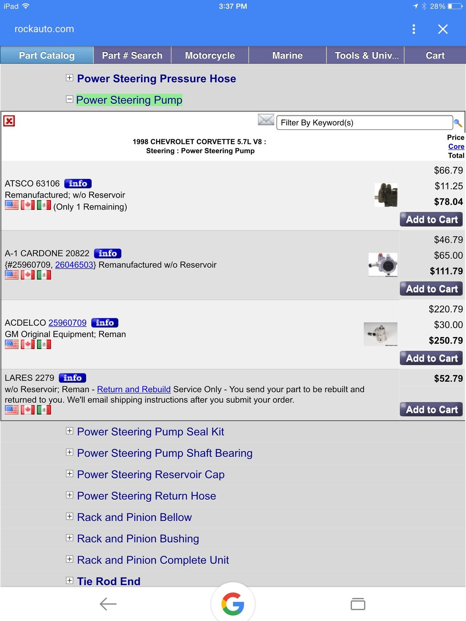

Not sure if rockauto.com ships to canada, but there on there for 115 in aluminum or 80 in steel. I looked at mine and it is indeed the steel because I'm cheap lol
