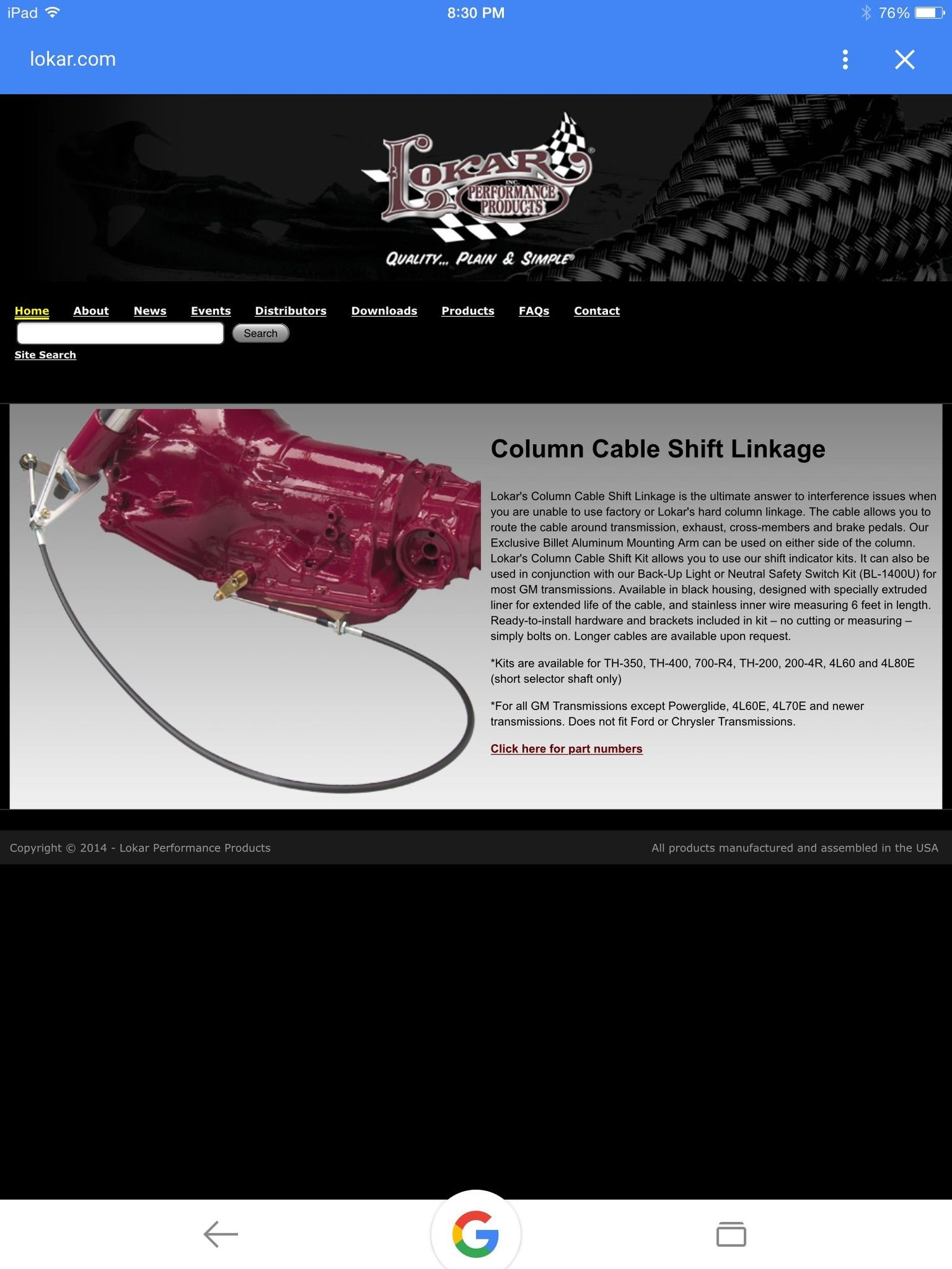

This will work
awsome thanks jimmy!!!! looks like ill be getting one of those if i want to keep column shift which i kinda like haha plus i dont feel like a steering column swap and to put stock floor shifter/console in you need to weld all the mounting brackets on to your column shift car its a bit of work to do it proper
That's a unanimous vote.

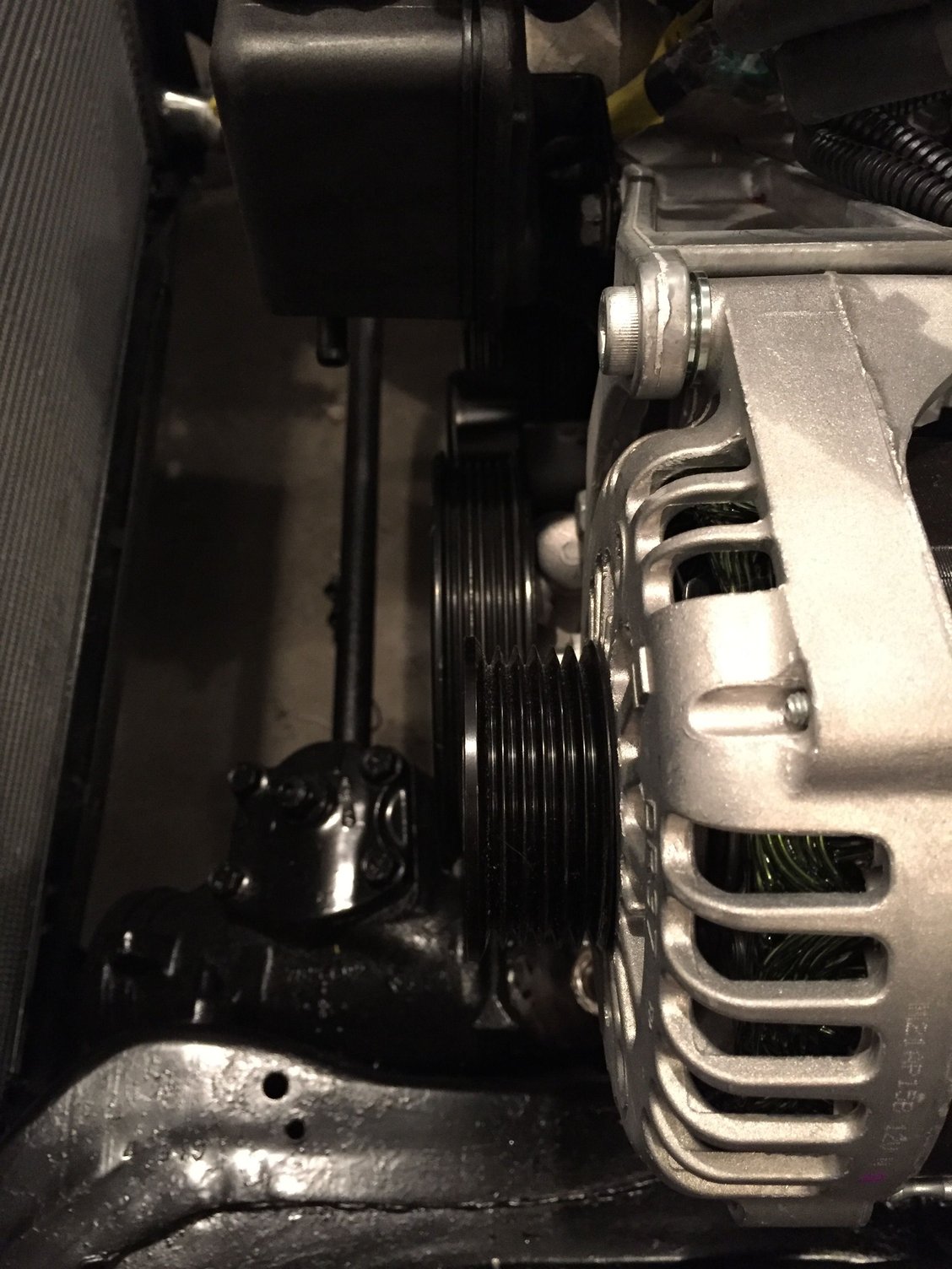

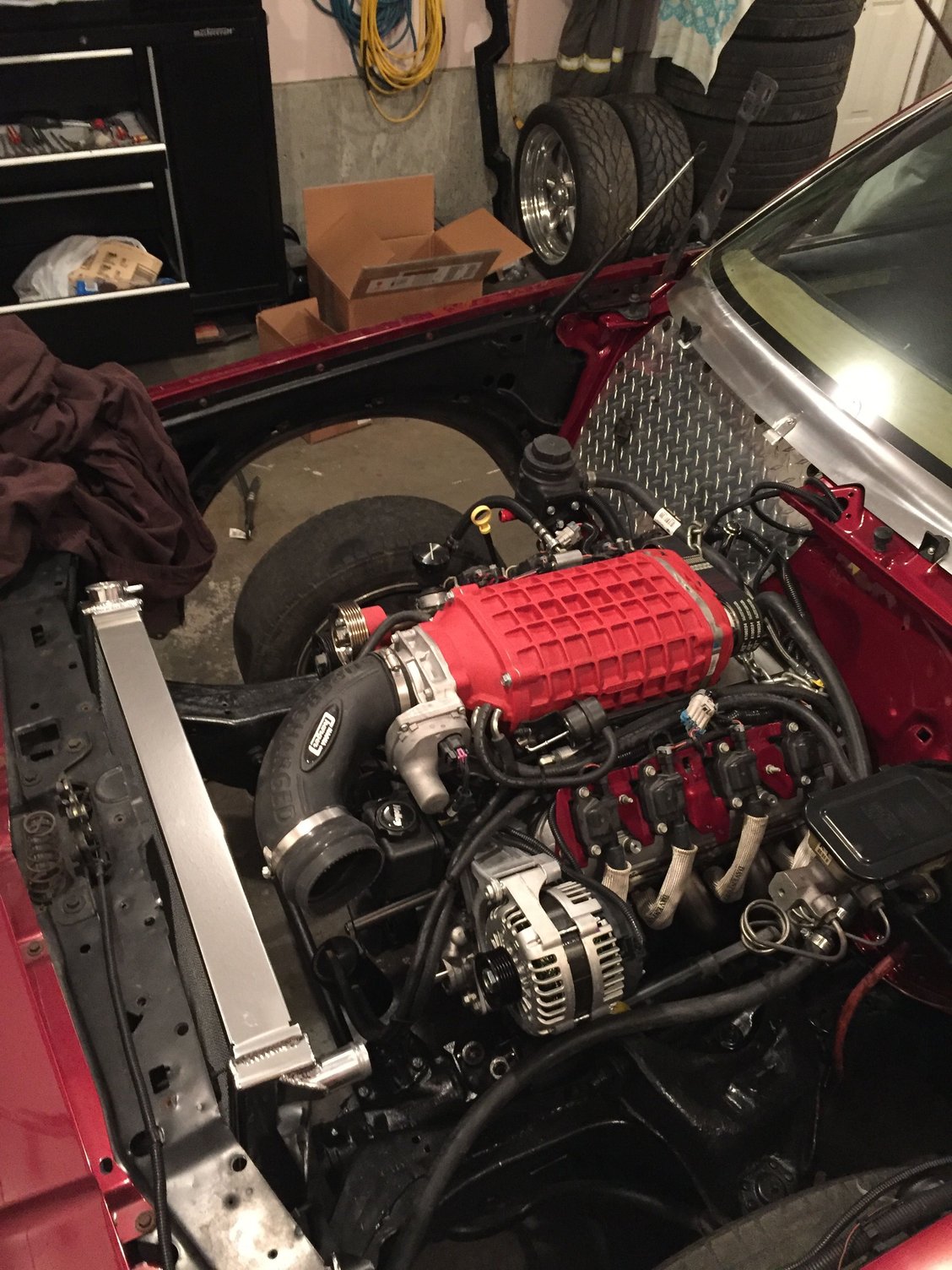

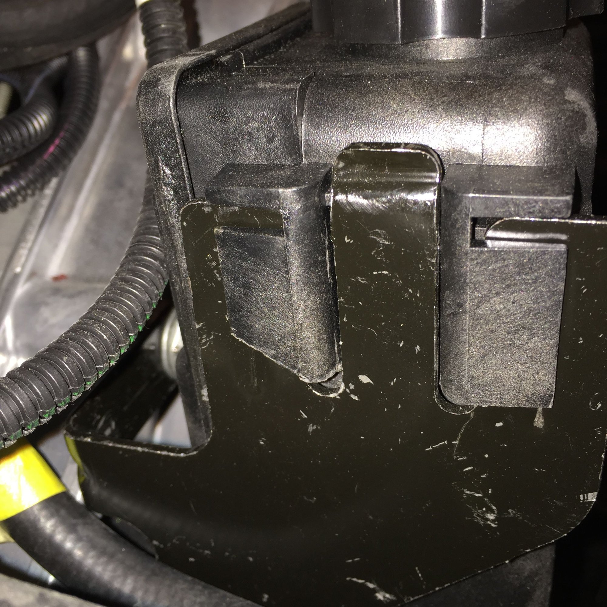

ok i got a box of parts today!!!
holley power steering pump, bracket, reservoir,and idler pulley. all of it installed perfect except i had to slightly trim a bit off the inner piece of the reservoir mount on tank (because of supercharger, ill show in next video) not important
so all was installed except the PS pulley so i bought the puller tool and pulled the one off of the stock 2010 ss camaro ps pump it was (looked) perfect in size but once i installed it all the way onto the shaft it sat too far outward, too bad since it was small enough to clear everything (steering box and fittings)
SO who knows the exact pulley to use and a part number? i dont wanna go buy a CTSV pulley for 100 bucks if im not positive its the correct one. so basically i need one with less... offset ill call it.
like a wheel has.
too bad one didn't come with the holley pump!!!
and if you know the exact fittings to use to clear the pulley, in the steering box, please include those part numbers too thanks

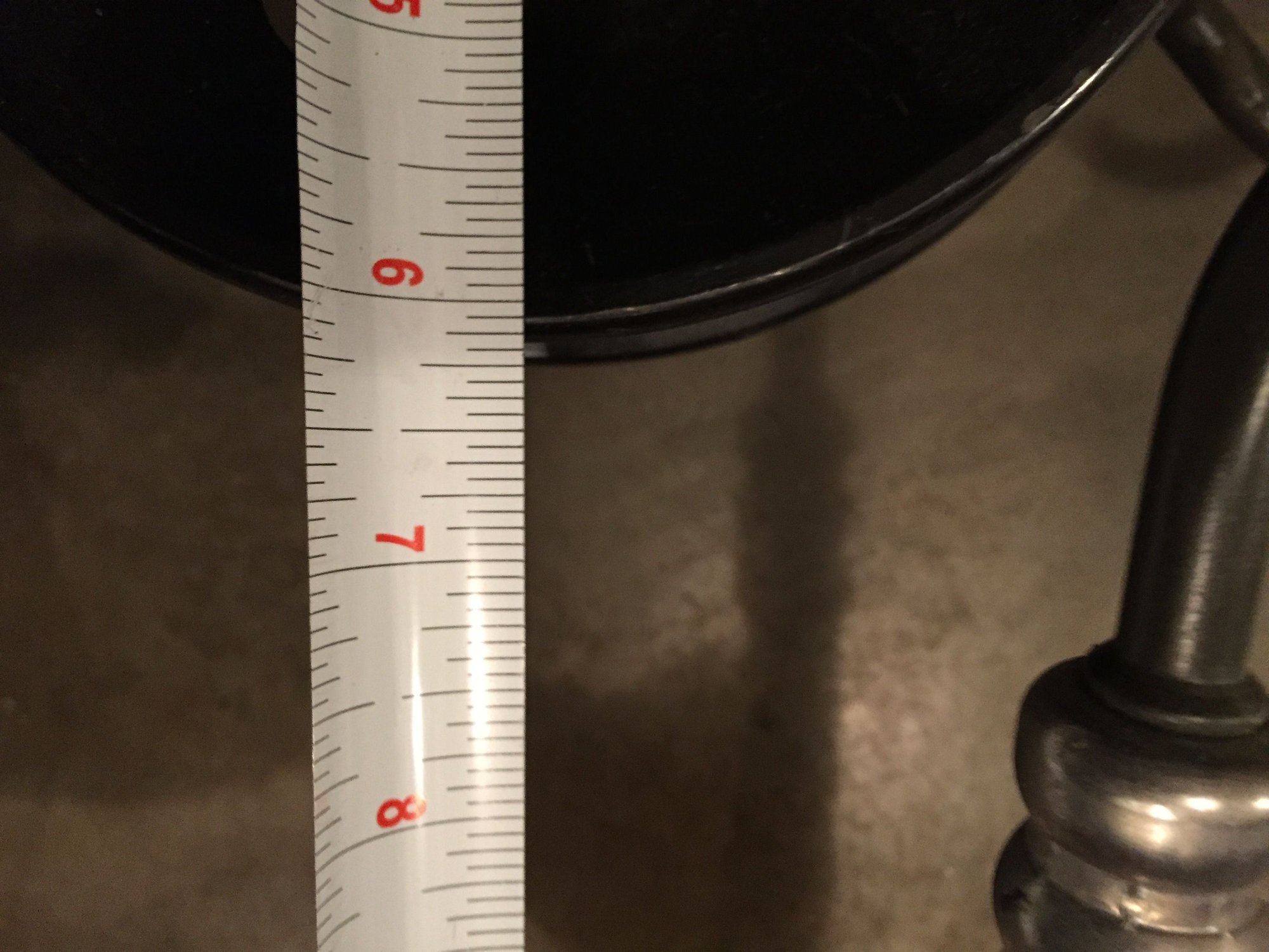

Yes it is the standard 605 box I'm
Pretty sure as it's just a base 305cu Buick Regal
That other pulley
(oem 2010 Camaro ss) measured
6-inches-3/16ths across plus or Minus a 16th and it looked to be a great fit if only it wasn't
so far outward so I think something close to that would work!!
The ps pulley sticking forward too far!!
Stock 2010 Camaro ss power steering pulley diameter
She's coming along
The tiny little corner I had to trim to be able to install and remove the Holley resivoir with the bracket installed due to throttle body being on opposite side as oem
