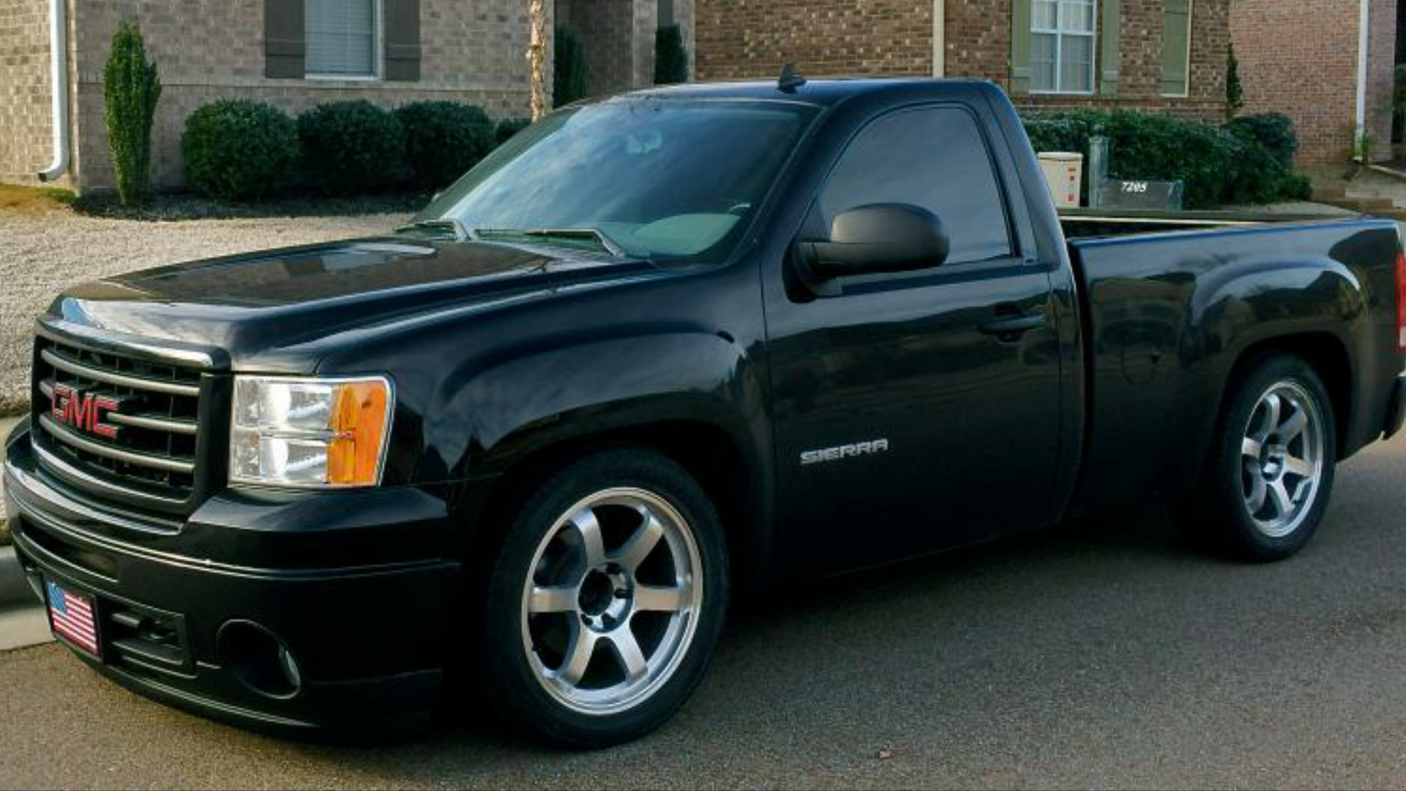

2012 RCSB, 4.8, 4L60, 4x4
Here is what I'm thinking.....
212/218 sub .600" lift on a 112 + 2
Springs - 140# seat, 375# nose
Big treadstone or similar
Single 50mm bov
Lock up Yank or circle D (3000-ish)
Pump E85
Walbro E450 & 90lbers
And here is where I need some input....the turbo choice.
This will be a t4 flange...
MP70
On3 72
Big 366
S472
S475
I really don't want to spin it above 6500. And I'd like to get after the power early and let the convertor do its magic. Looking for a fat power band from 4k to 6k.
And as far as max power is concerned, I don't have a goal, I just want to push it pretty hard (700wheel ??).
What's your thoughts and suggestions ??
Thanks.....
