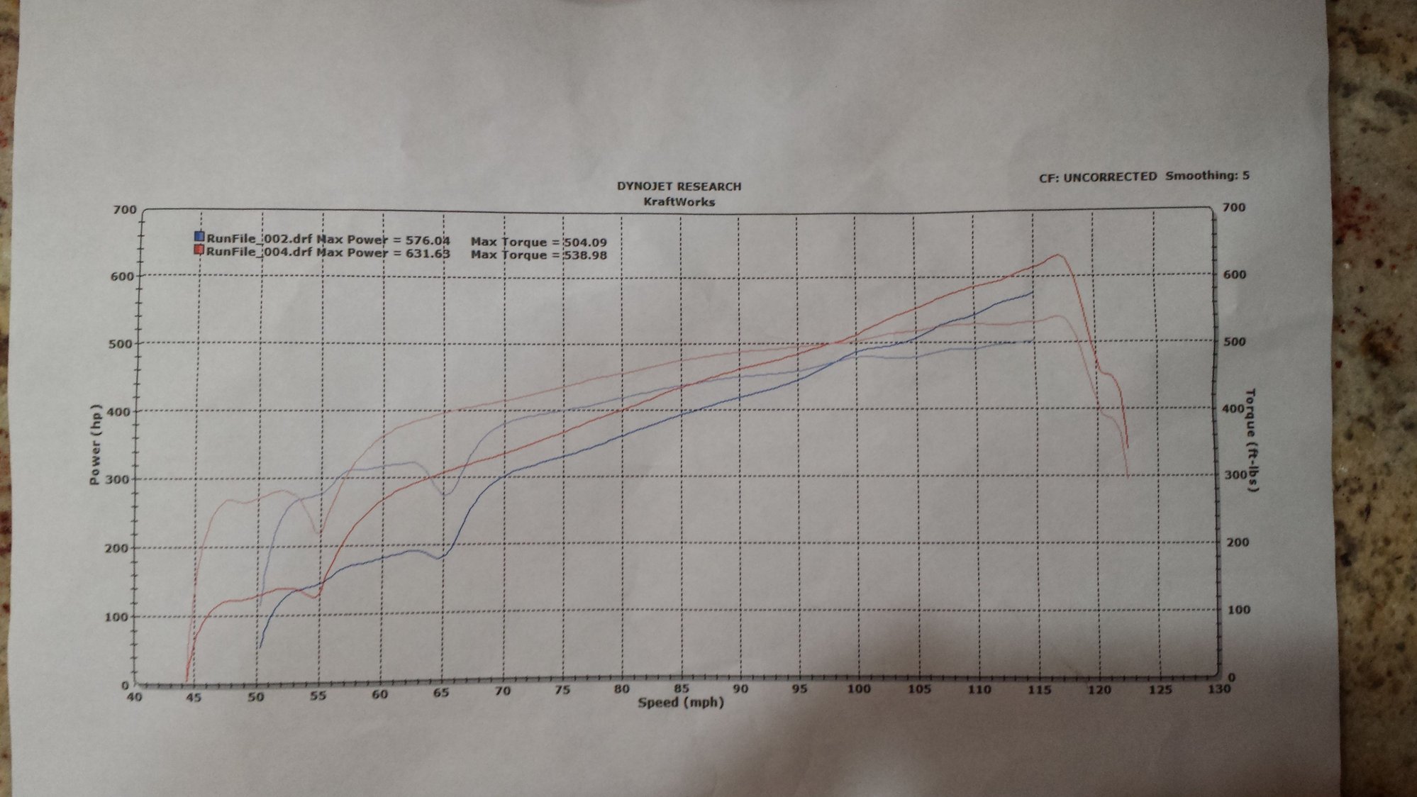

  #145
Longblue's Avatar
Joined: Mar 2016
Posts: 51
Originally Posted by Blown06
I'll add to the above post a little food for thought on Centri blower set ups vs. turbos.
Typcially, turbo cars reach their total boost at a much lower rpm than a centri blower. Because of this, really hot centri cars sometimes don't even make a peak torque number. Especially ones that are "ratio'd" in a fashion where boost is climbing all the way to your redline/shift points. My truck is a pretty good example of that. I run an F2 and the few times when I made passes around 26 psi, you just don't see the V/E numbers falling by the shift point.
What I'm getting at hear is that tuning for safety/reliability is completely different from a turbo car to a centri car.
Here's my graph that shows this. 5.3 with a F1D Procharger. Torque starts leveling but never goes flat.
