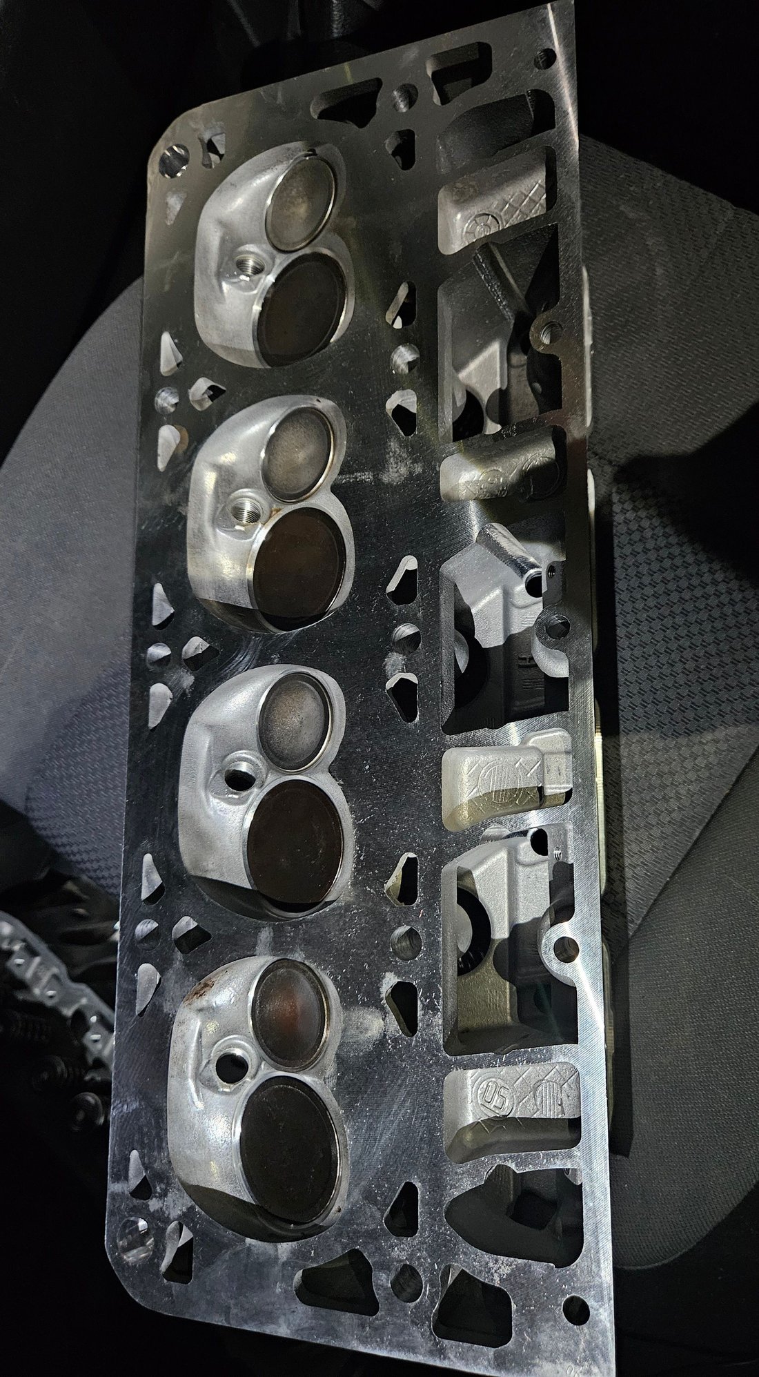

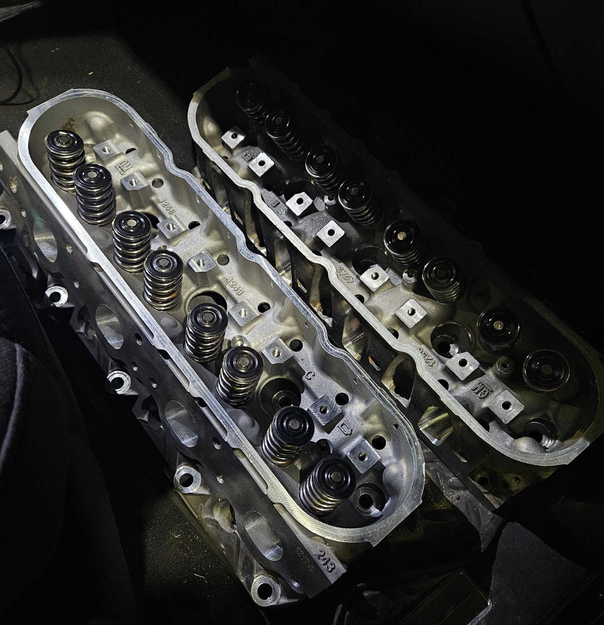

Got the heads back today, looking pretty good. Had to cut to .040 to get the surface right on the 1 head we kept

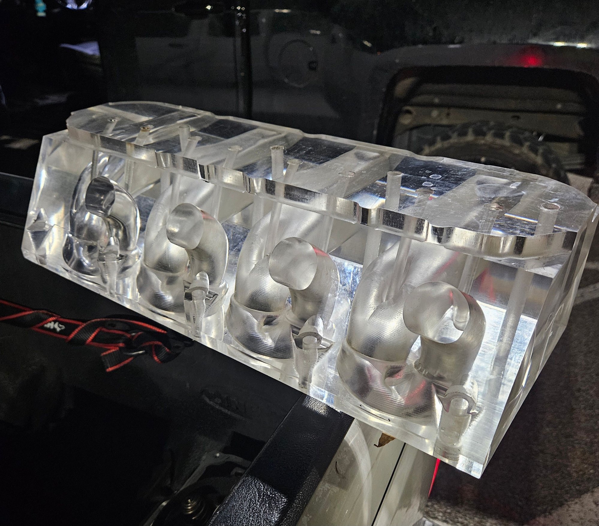

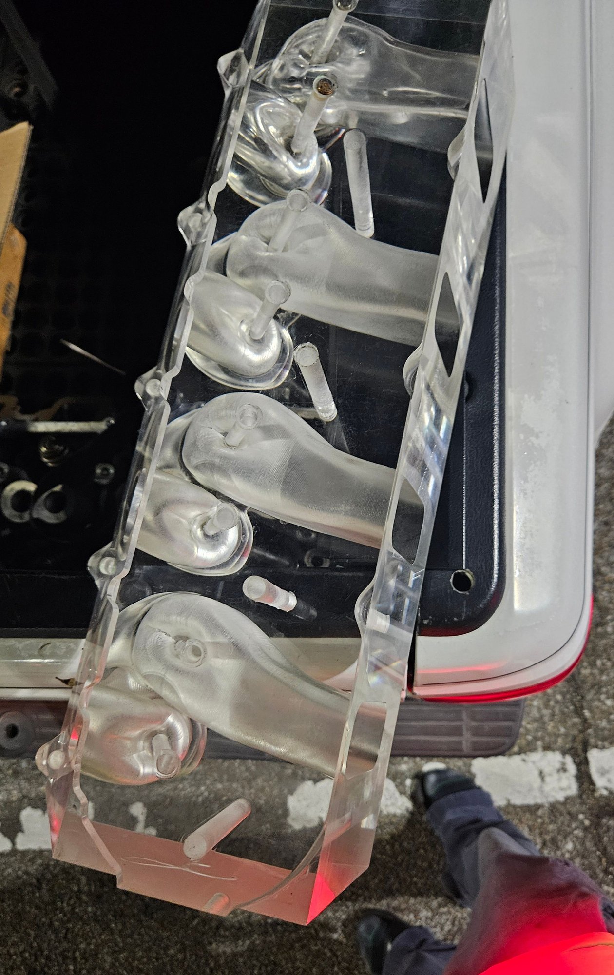

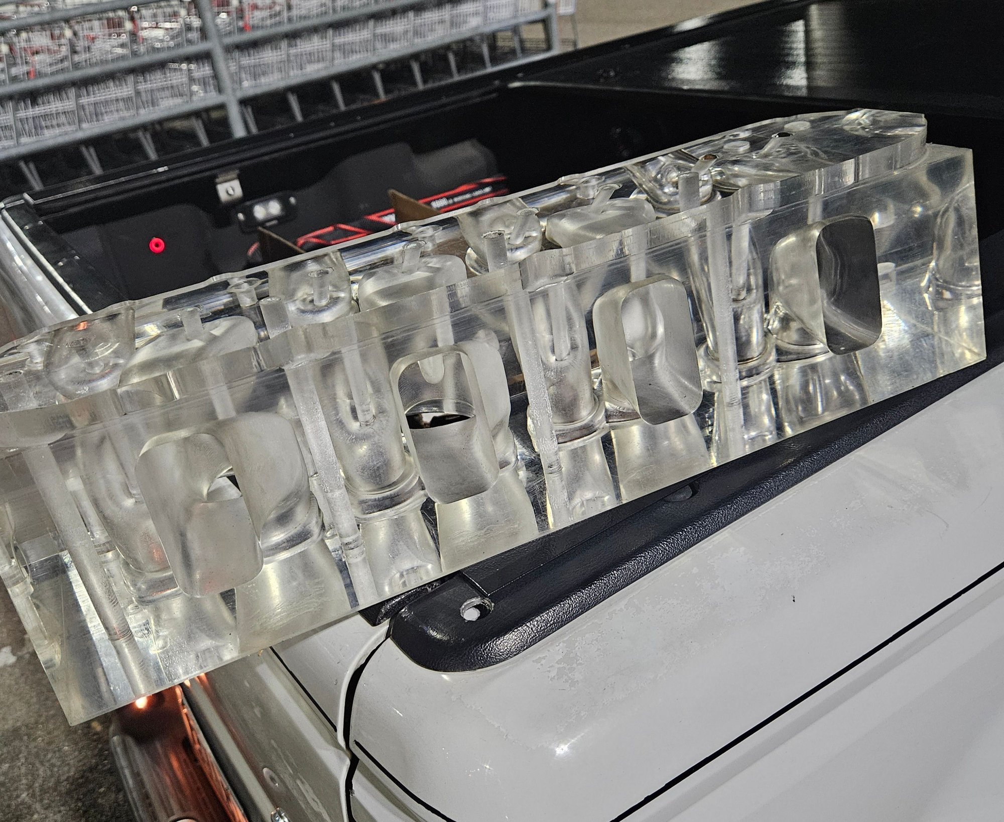

I thought this was pretty bad *** too, they guys had some model heads made of some kind of plexiglass looking material that they use for shows. These guys do good work
