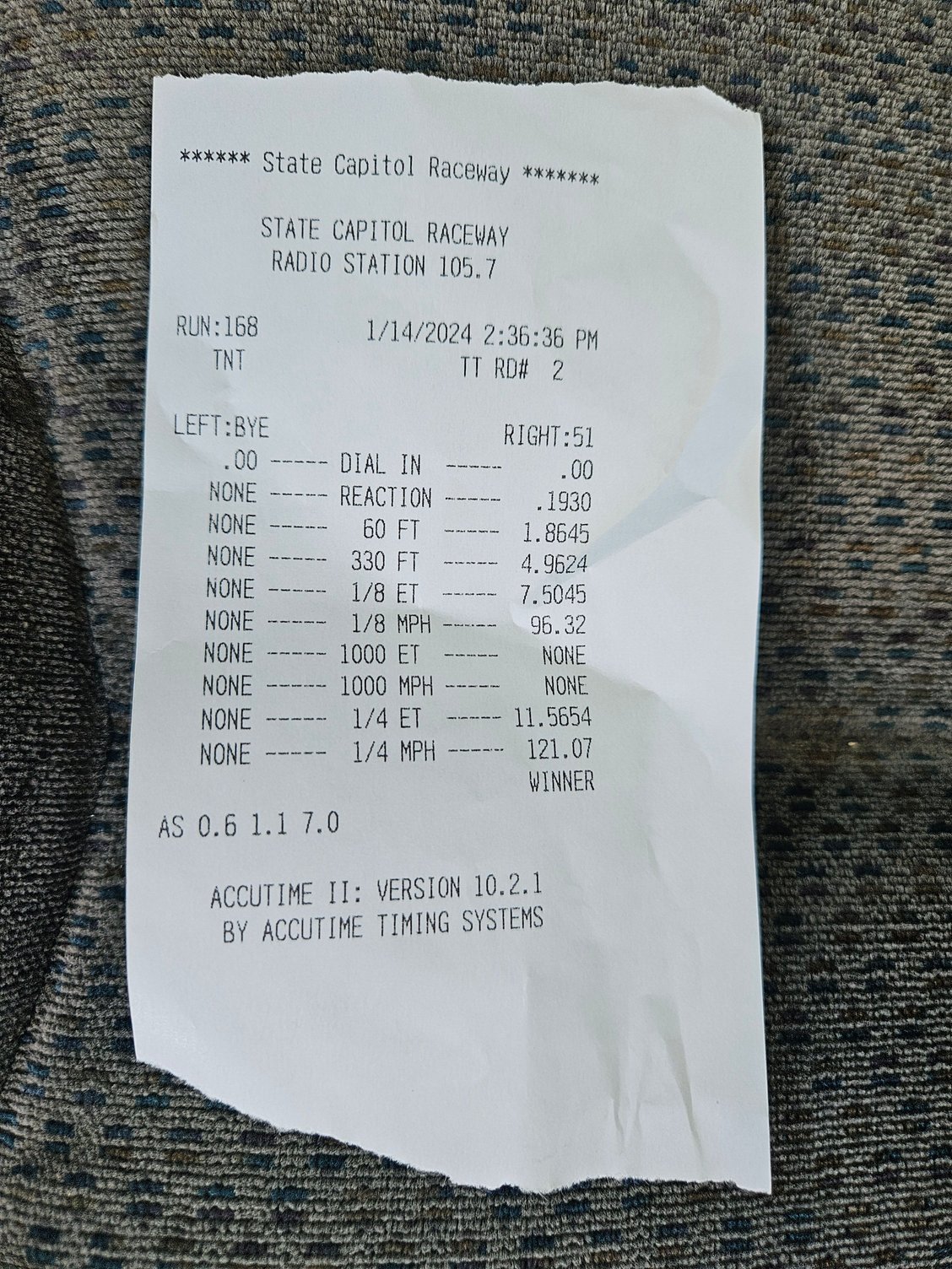

Mph was decent but time wasnt what i wanted to see. Definitely wanting to get this thing in the 10's. One thing i did notice was 1st and 2nd gear was getting 13 psi and once i got into 3rd it jumped up to 16.8 psi and thats where my mph came from, but why wouldn't it hold 16.8 in all gears.

Back halfing 25 mph in a full size truck - nicely done!
I don't recall which controller you have on the truck but it might need some tweaks. Low gear has less head and load, so it's not uncommon for it to be lower in low gears.

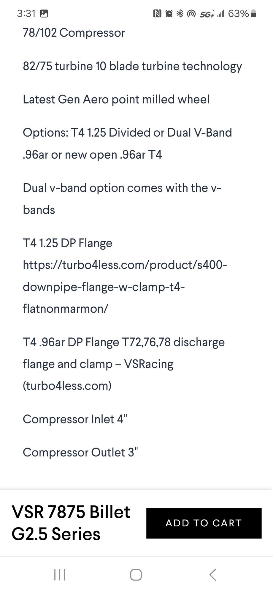

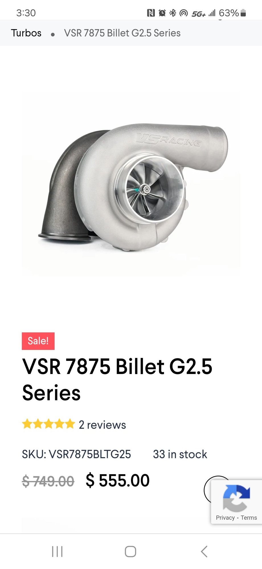

I ordered this one, going to do a 4 inch exit out the bottom corner of the fron bumper. Hopefully this will get me there

You're a good 60ft away from tens. If it's not on a good tire that'll be your biggest bang for the buck

mathematically a 1.50 60ft would be enough for 10s

once i change the turbo ill try and bump up my 2 step a hair and see if I can get a little more of the 60. My reaction is spot on so I don't think it's driver error.

The timing lights don't give a **** about reaction time. Just take your time and only worry about the individual variables you can change one at a time to get your best launch. Once you have that down to the best setup for your truck, you can go back to things like reaction time that only matter for actual racing. Just don't do things like changing tire pressure AND trying different launch rpm AND different shock adjustments at the same time. You will never know which variable did what.
