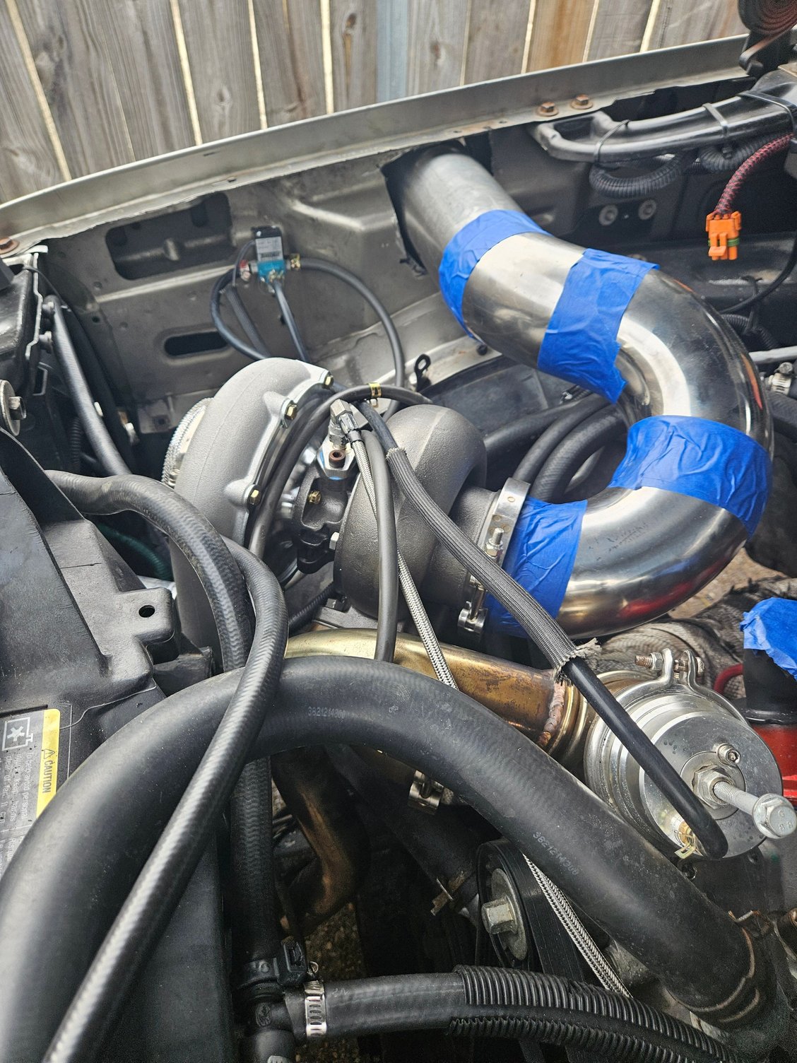

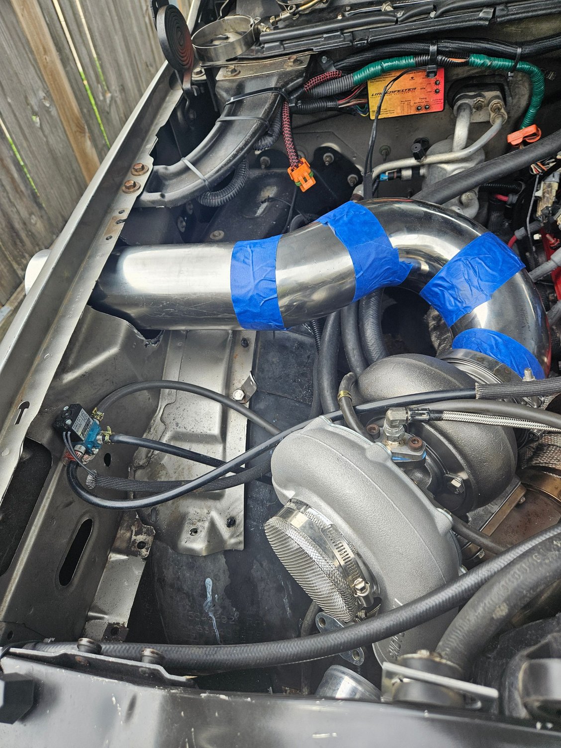

Just a test fit, still need to weld but it's working out Allright

Ditch that small mesh screen, they kill flow on turbos.
Get a turbo guard with the large holes or the biggest filter you can fit.
really? It's not an actual guard. Its a sheet of metal mesh that I bought and cut out and made fit around it.
For real, that screen will be worse than a regular air filter. More restrictive than the honeycomb people take out of MAFs.

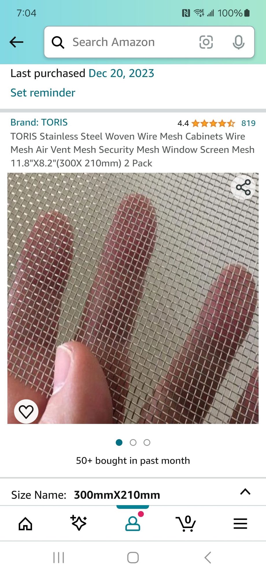

Wow I had no clue, I've been having the screen even on the old turbo. This is what I used. What do you guys use?

Turbo guard is mesh, im not understanding how that's different
You either need a shape that increases the surface area to make up for the area the screen physically blocks, or such large holes as to only guard your turbo from large rodents or small children. So yes, most turbo guards are crap as well.

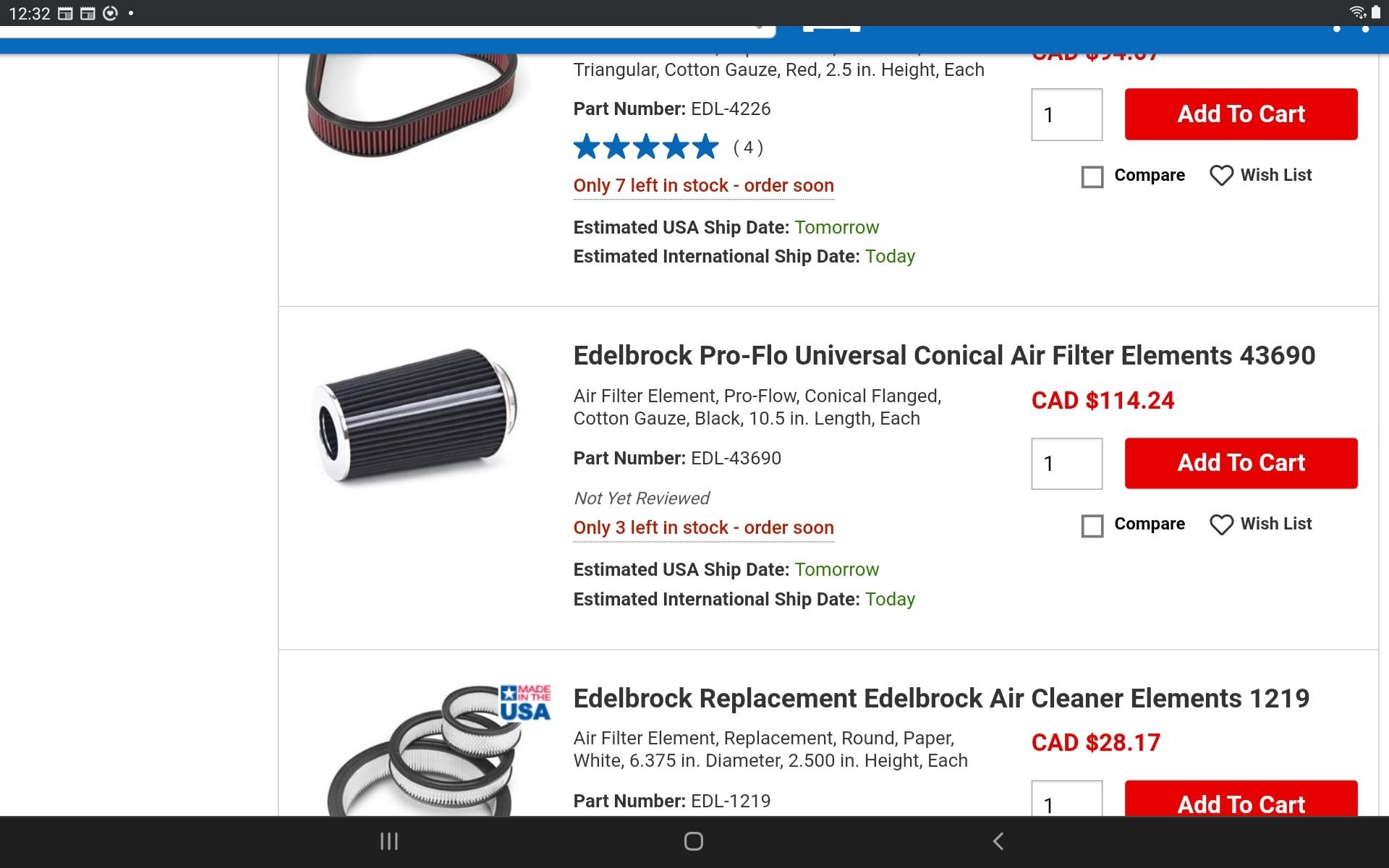

Old Feb 11, 2024 | 11:39 AM
  #513
GMCGreg's Avatar
Joined: Feb 2020
Posts: 734
Likes: 209
I'm running that one . Have planned on using a gauge to measure the restriction but haven't yet cause it just keeps going faster Lol.
lol I wouldn't complain then, when I take it to my tuner I'll make a pull with and without the screen to see what kind of difference it makes. I can't fit a big air filter like that. I Maybe have about 6 inch of clearance so I'm limited.

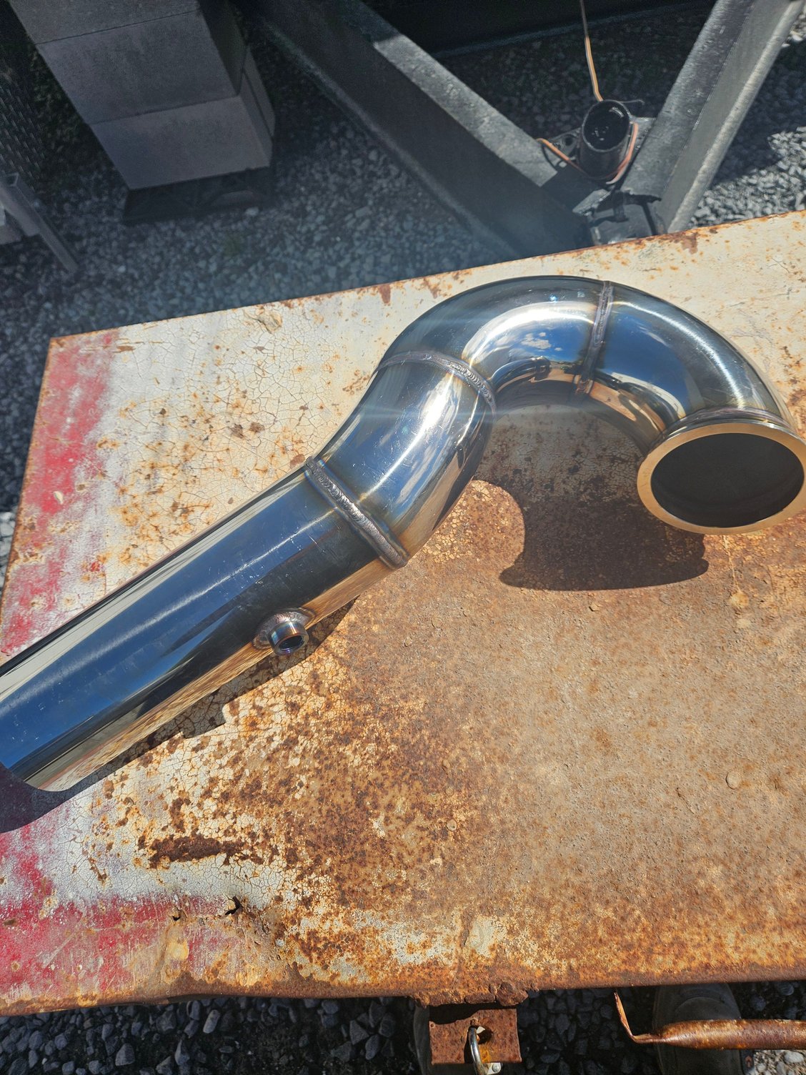

Fender exit is welded!
