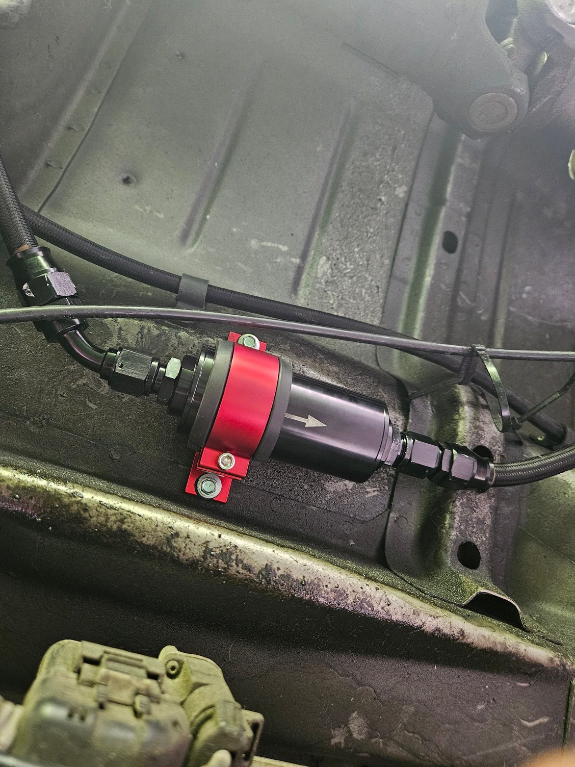

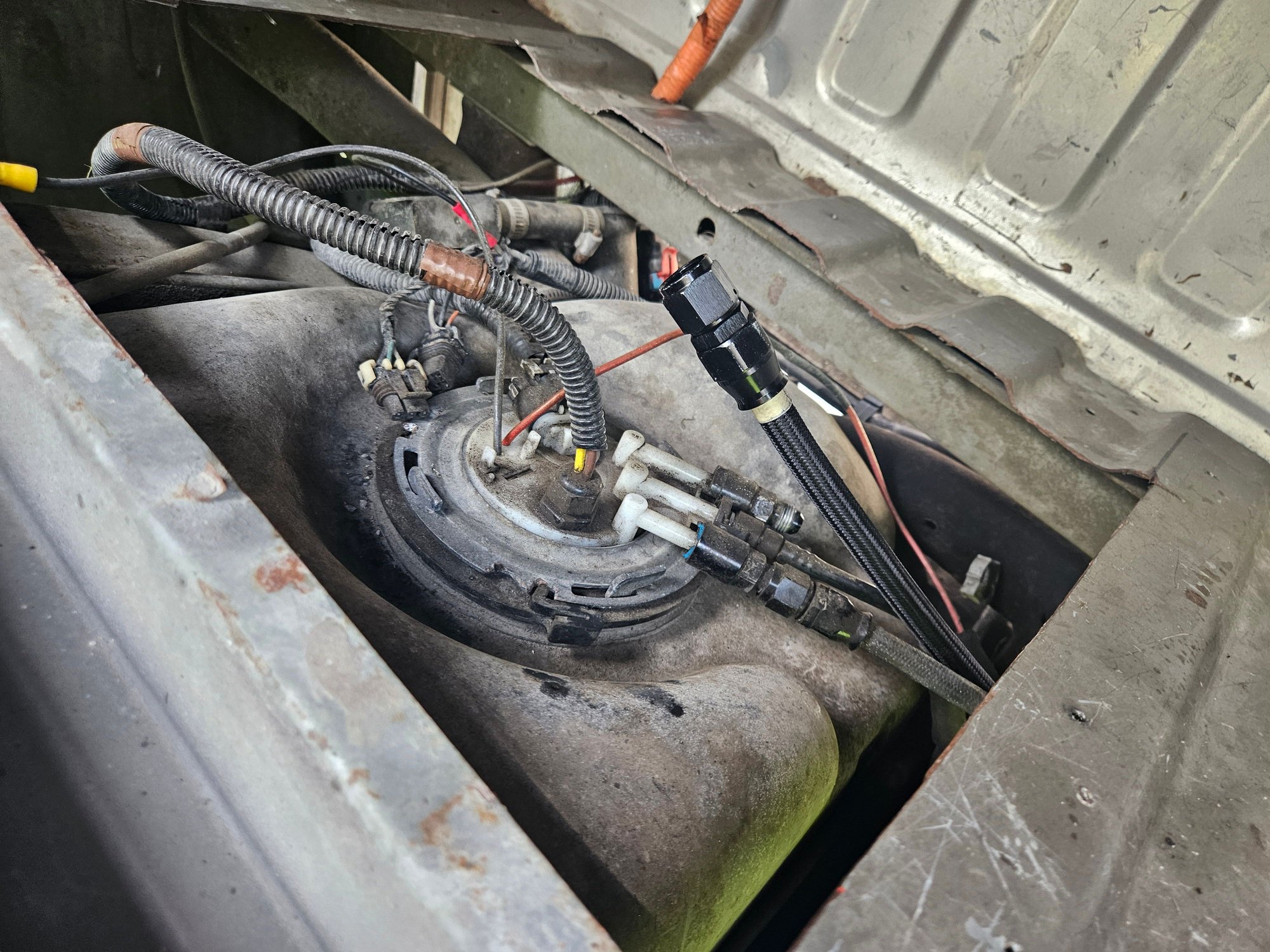

8an line ran from pump to splitter then to back of the rails, waiting on dual 525 pumps to come in the mail

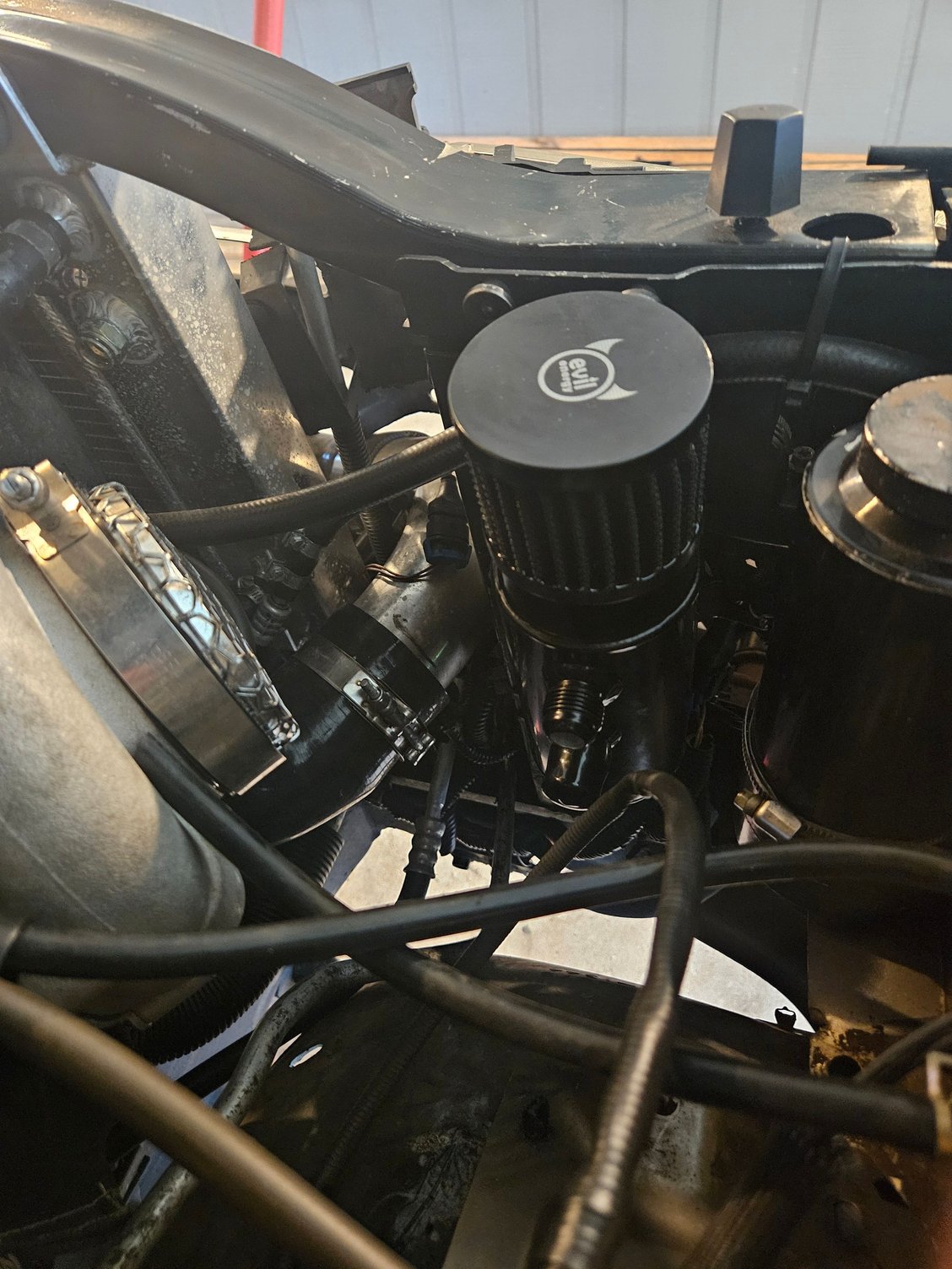

Also going to weld these 10 an bungs on the valve covers so I can use 10 an braided lines to the catch can
Old Jun 16, 2024 | 01:48 PM
  #699
Tommy42088's Avatar
Joined: Oct 2022
Posts: 1,776
Likes: 626
From: Louisiana
Moved the catch can here

The fuel lines now split into the back of the fuel rails and the front on the rails are 6an that go into each side of the regulator and the return out the bottom into the flex fuel sensor then from there back to the tank
