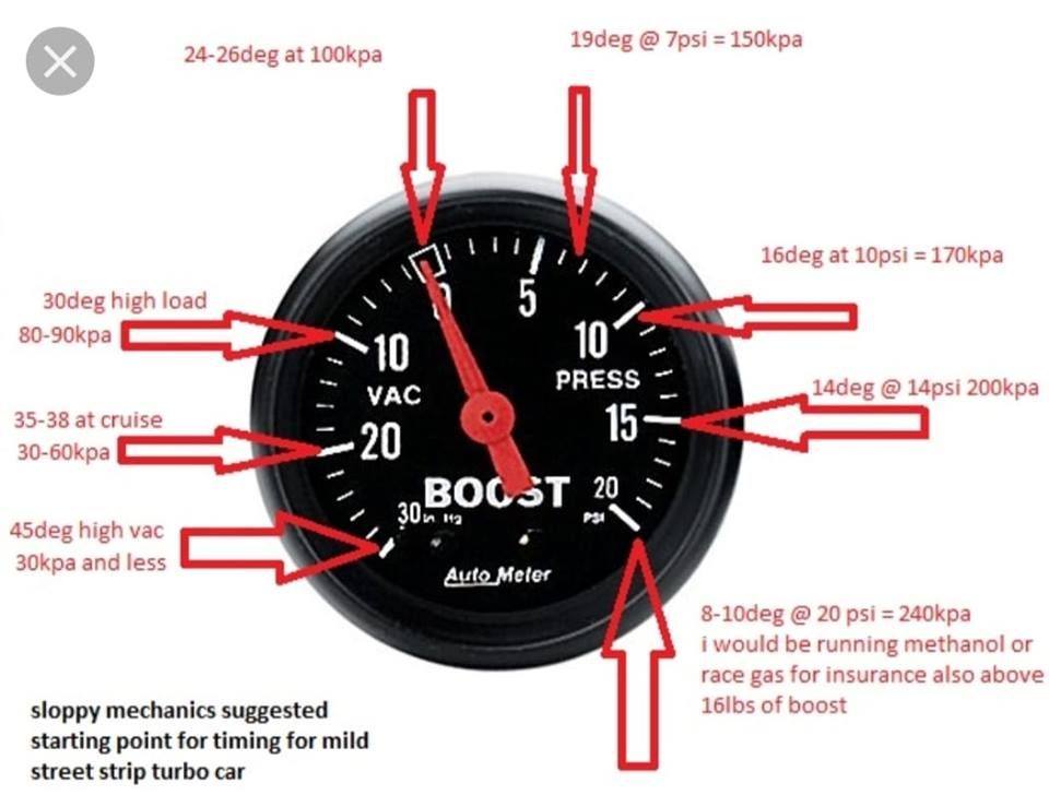

Another thing what should my timing table look like? At 0psi i'm at 27* and pulls .75 - 1* per psi. Is that too high? I'm eventually gonna have it professionally tuned before it gets turned up but just for now on low boost.

3 lbs. on a 4.5 lb spring doesn't sound too far off, it's not a 1:1 ratio with waste gate springs.
A 5.3L on 3 lbs. isn't going to set the world on fire my friend, the turbo is barely even working at this point.
Keep the timing NA until 1-2 lbs. then start pulling it out, get it making 10 lbs. w/ 16 degrees and it'll wake up.
