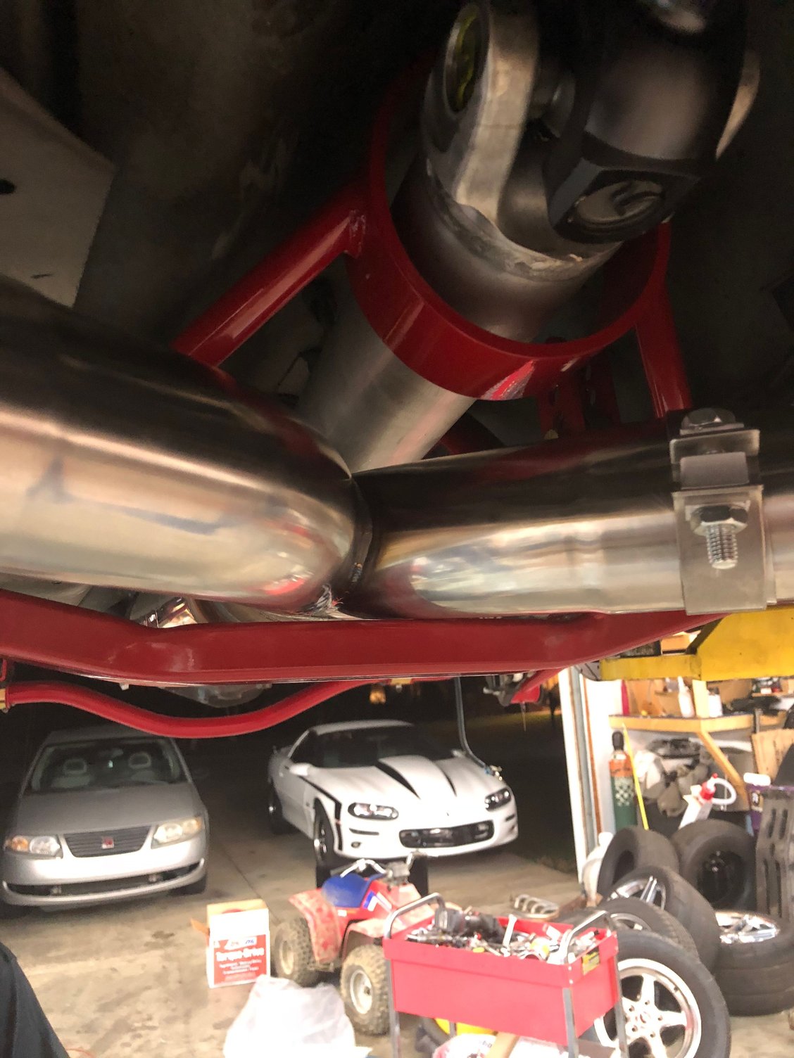

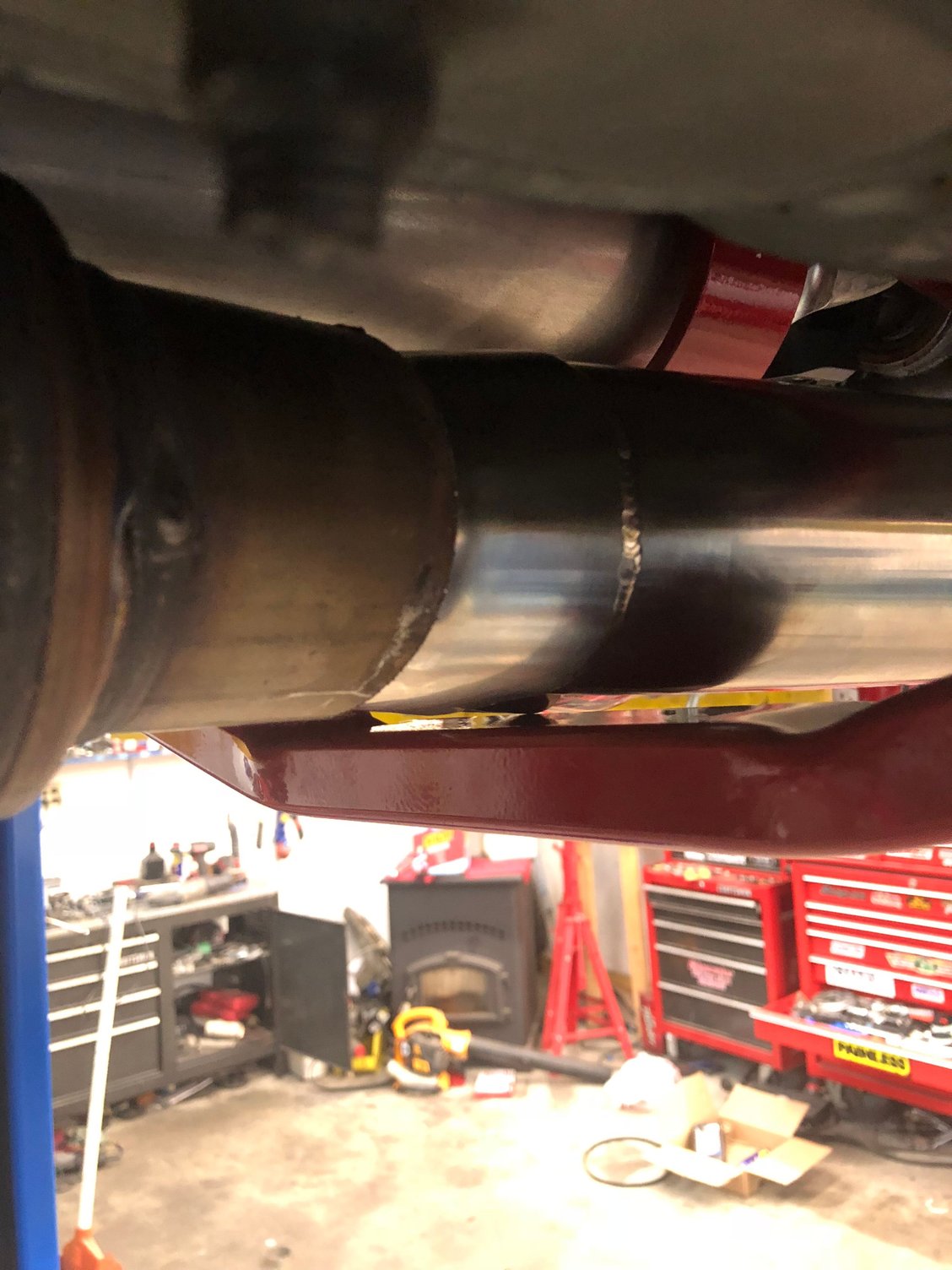

If majority of people are receiving their set undamaged with no complaints, then it's clearly the fault of FedEx and how they handled the package and not how they were packed, seeing as how they are all packed the same. Mine were packed the same way and arrived mint.
Proper customer service:
Speed Engineering files an insurance claim with FedEx. You send them back the damaged parts after Speed Engineering sends you a pre-paid shipping label and RMA number, which I'm assuming is a pdf that they emailed you already? Then once they get the parts, they immediately ship you another set without waiting for reimbursement from the Fedex claim. FedEx then must reimburse them for the cost of shipping the damaged set back, the part itself, and the shipping charges for Speed Engineering to send you out another set. Why should FedEx be allowed to not pay for their mistake because some Ace Ventura lookin **** damaged the package? They absolutely should. That's the whole point of the vendor filing an insurance claim.
Also I hope we are NOT expecting the Y pipe to be a perfect fit and work with every single cross member without any clearance issues. That's called having a "pipe dream". Literally. I can tell you right now for a fact that there is clearance issues with the speed engineering Y pipe and MWC double drop cross member. The MWC 3.5 catback cross member would require serious modification to the Y pipe. I know because I test fit both of them and the MWC double drop wound up being the better option, but modification is still required because it's a very tight fit.

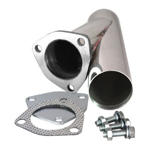

Now do you do this by simply adding in additional 3" pipe? No, you do it correct by using cutouts. Why pay for additional stainless steel when you can use the length from the cutouts to make the adjustment? Cutouts all day every day. Want to close them? Press a button in the cabin. Done and done.
I will post new pics next week once the adjustments are make to the Y pipe so that you can see ground clearance, fitment, etc.
Also, I will be using these clamps:
Clamps: walker 33272
Cutouts: QTP 3" stainless 10300
Electric cutouts: DMH, 3"
