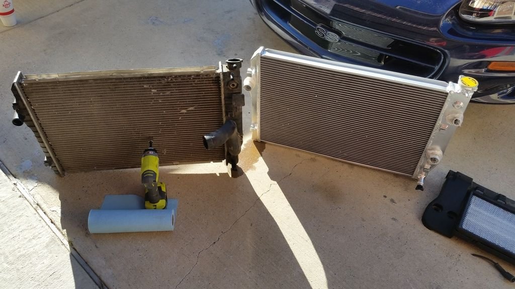

My ebay aluminum setup also works just fine, and fit better than the be cool according to a few threads I've seen. The be cool has a 2.5 core and the ebay is basically a dual core like an lt1 with aluminum end tanks

Also running the ebay version. Its also meant for the v6 and doesnt have a port for the steam tubes. I had a bung welded on mine and used an lines.

It's technically listed as a 2002 camaro v6 radiator. You need to tap the radiator below the cap to add the coolant cross over hose from the cylinder heads. I just tapped the old radiator level switch with a 3/8 hose barbed fitting

The ebay ones come with the trans cooler built in, you can leave them capped and not use them. I've debated just running the heater hoses to them and bypassing my heater core if my hoses ever fail to the core

I also had the same problem with the eBay radiator. I ended up trimming the top and bottom of the fan shroud and cutting the aluminum slide in brackets to help the shroud sit flush against the fan. Photobucket changed its terms and does not remote link photos
Anyways, the aluminum bracket that holds the fan is a square with a tab on it, I cut the top part of the square to make the radiator fan sit right against the radiator
