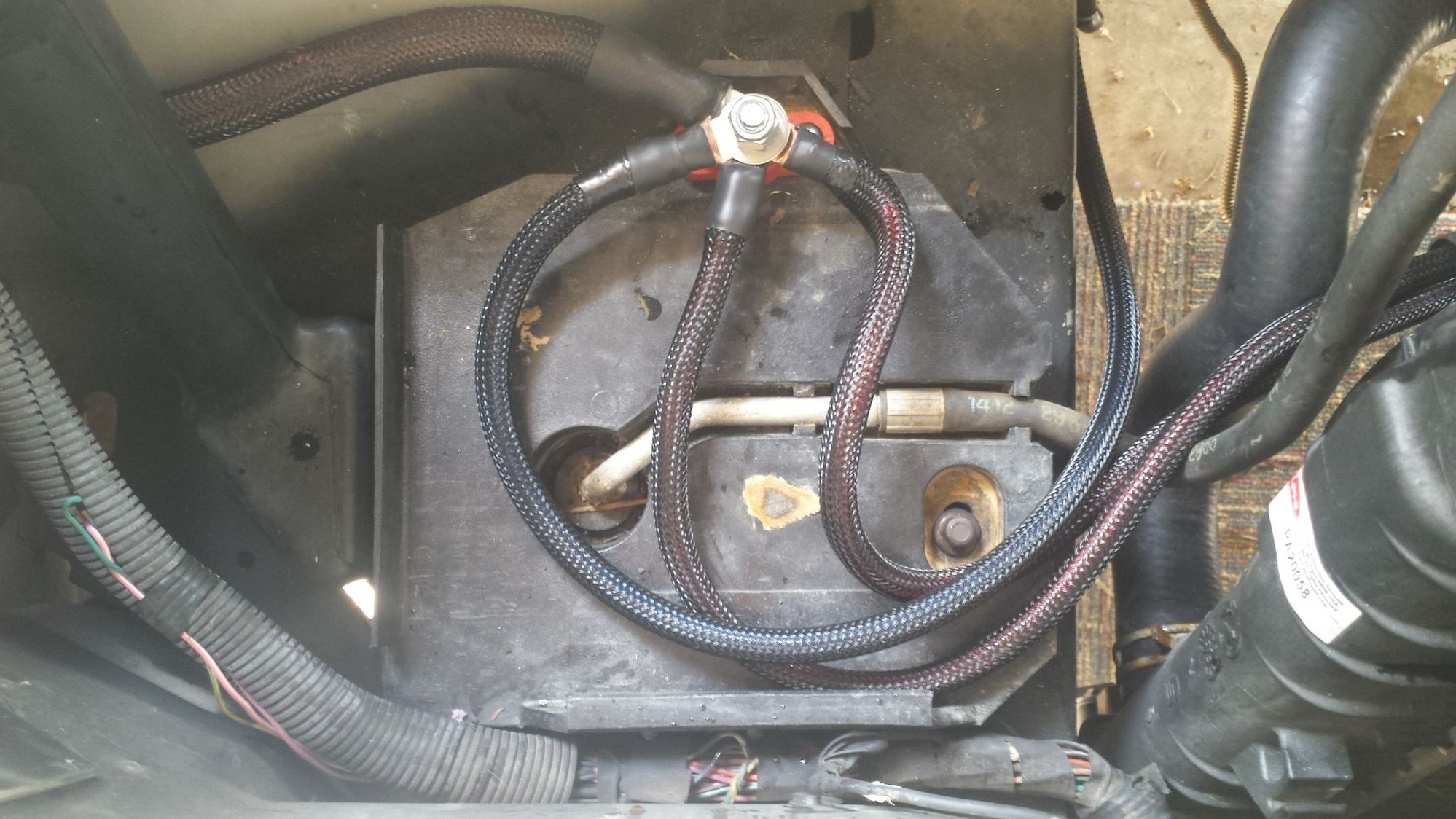

Old Jul 31, 2018 | 01:54 PM
Full-Force's Avatar
Posts: 3,070
From: Upstate of SC
Originally Posted by 5.7stroker
4 awg will be fine. Be careful.... it starts off as just an "alt upgrade and big cable" but then quickly turns into something else. See here:
https://ls1tech.com/forums/generatio...elocation.html
This is what I have where my battery used to be. Battery is now in trunk using BMR relocation kit.
1/0 gauge from battery + to the junction post with ANL fuse right off the battery
1/0 gauge from battery - to chassis ground in trunk.
4 gauge to starter
4 gauge to alt
4 gauge to +post on fuse box
Old Jul 31, 2018 | 02:01 PM
sjsingle1's Avatar
Joined: Feb 2010
Posts: 6,755
Likes: 292
From: Fort Worth TX
^^ what kinda cable sleeve is that....looks nice
Old Jul 31, 2018 | 03:17 PM
Full-Force's Avatar
Posts: 3,070
From: Upstate of SC
It's called techflex. It's stuff I use in my stereo installs. Its abrasion resistant, and visually blends into the factory harnesses better than just a bunch of different color jacketed wires.
All of my connections have hydraulic crimped copper lugs with adhesive lined heat shrink. Should be a permanent connection and never have any corrosion.
