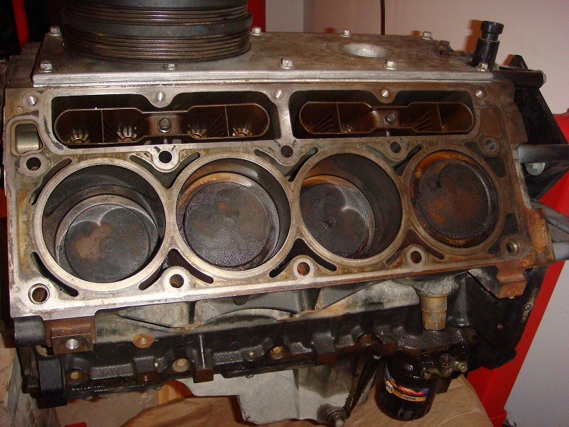

Lets try this another way then... If you look at an ls aluminum block you will see they have steel sleeves inbedded into the aluminum block. Now these liners can only be bored .010 before they become too thin. It has nothing to do with block thickness it has everything to do with the stock cylinder steel liners now becoming too thin and prone to cracking.

Stock Ls block notice the different color liners in the bores
By sleeving it you basically bore the old sleeve out of the block and continue to bore out the block for whatever type of sleeve you will be using. In a dry sleeve the sleeves fit into the area where the stock liners were and never comes into contact with the coolant as the stock cylinder walls in the block are still retained just bored out bigger to make room for the sleeve. a dry sleeve uses the stock coolant passages in the block never comes into contact with coolant thus the name dry sleeve....
