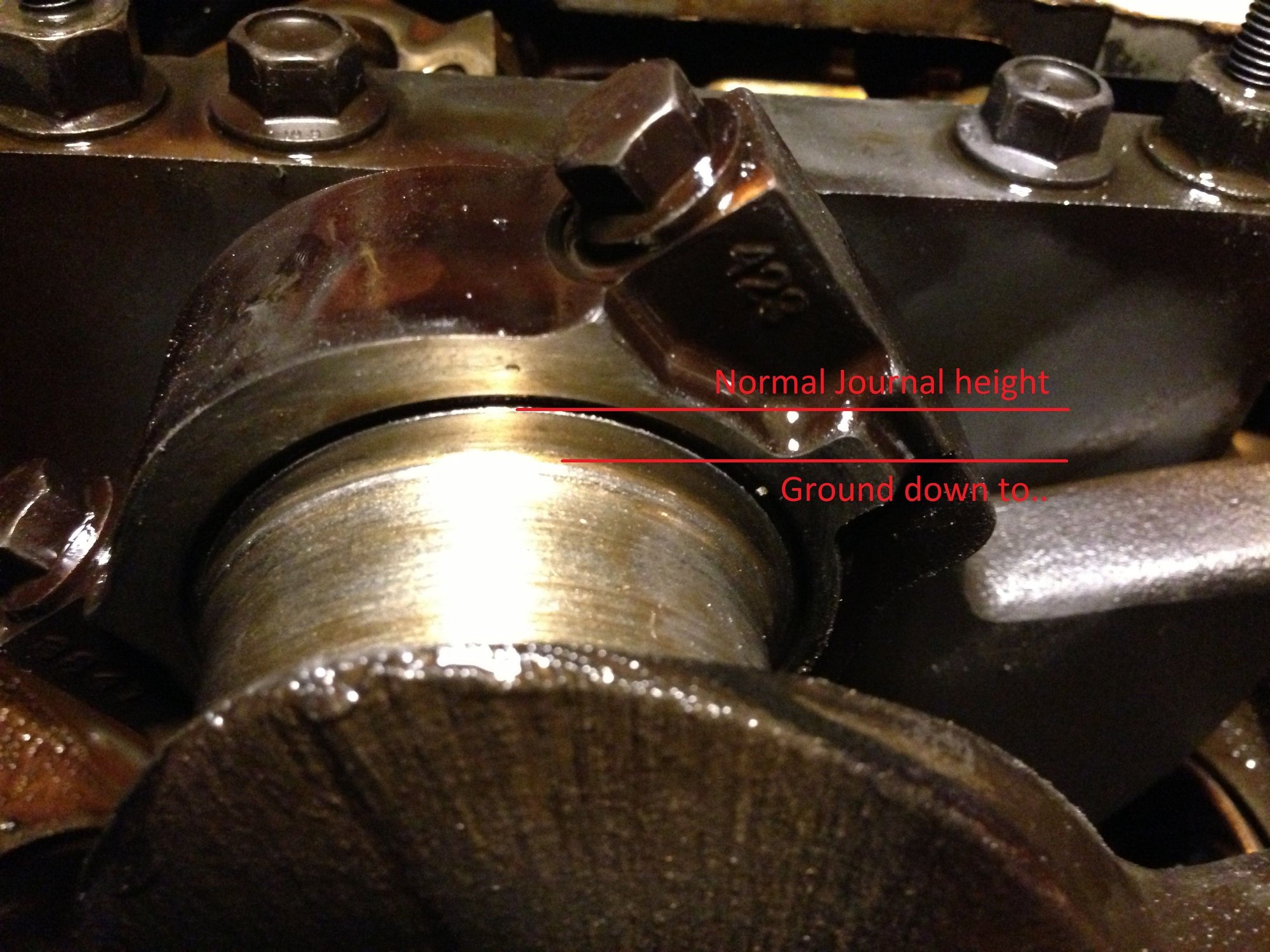

Bad news. #2 rod spun and sand papered the engine, least the piston skirts and cylinder walls, thought he cylinders might be able to be honed, bored worst case scenario. I have not got any farther than heads, oil pan and #2 rod off, but, not looking good. I will keep you informed.
