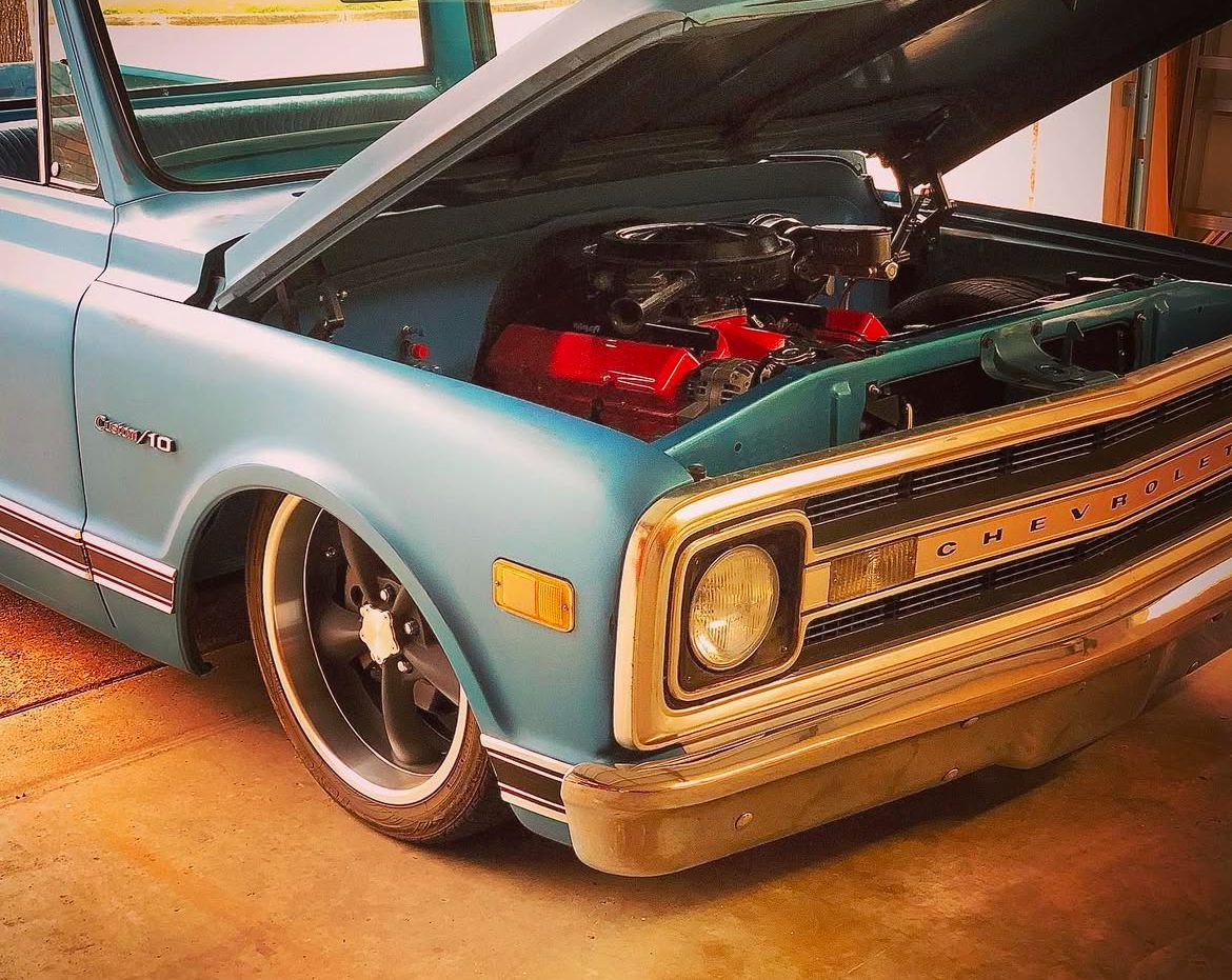

Agree 100%. It is KILLING what little low end I have on the little stock 5.3 I’m running now. Combined with the BTR stage 3 truck cam and it’s a complete dog until like 4500, then it screams!
The intake has the “look” I’m going for though, as the motor is dressed like an old orange small block—itsa 1970 C10. I am strongly considering a TBSS/NNBS intake and just keeping the hood closed…
100% agree if it something like the Victor Jr. Is your single plane something like this? This one states 2500-7000 rpm
https://www.summitracing.com/parts/h...hoCitgQAvD_BwE
I’m using this one, same 2500-7500 range though:
https://www.holley.com/products/engine/intake_manifolds/efi_intake_manifolds/cast/single_plane/parts/300-136
Hoping the 4” stroke can make up for some of the misgivings of the pretty intake. Thinking a fairly mild cam might be enough to make up for it?

It’s got the look, but I want the driveability, too. I know, classic competing priorities. Can the stroker overcome the poorly matched intake?
