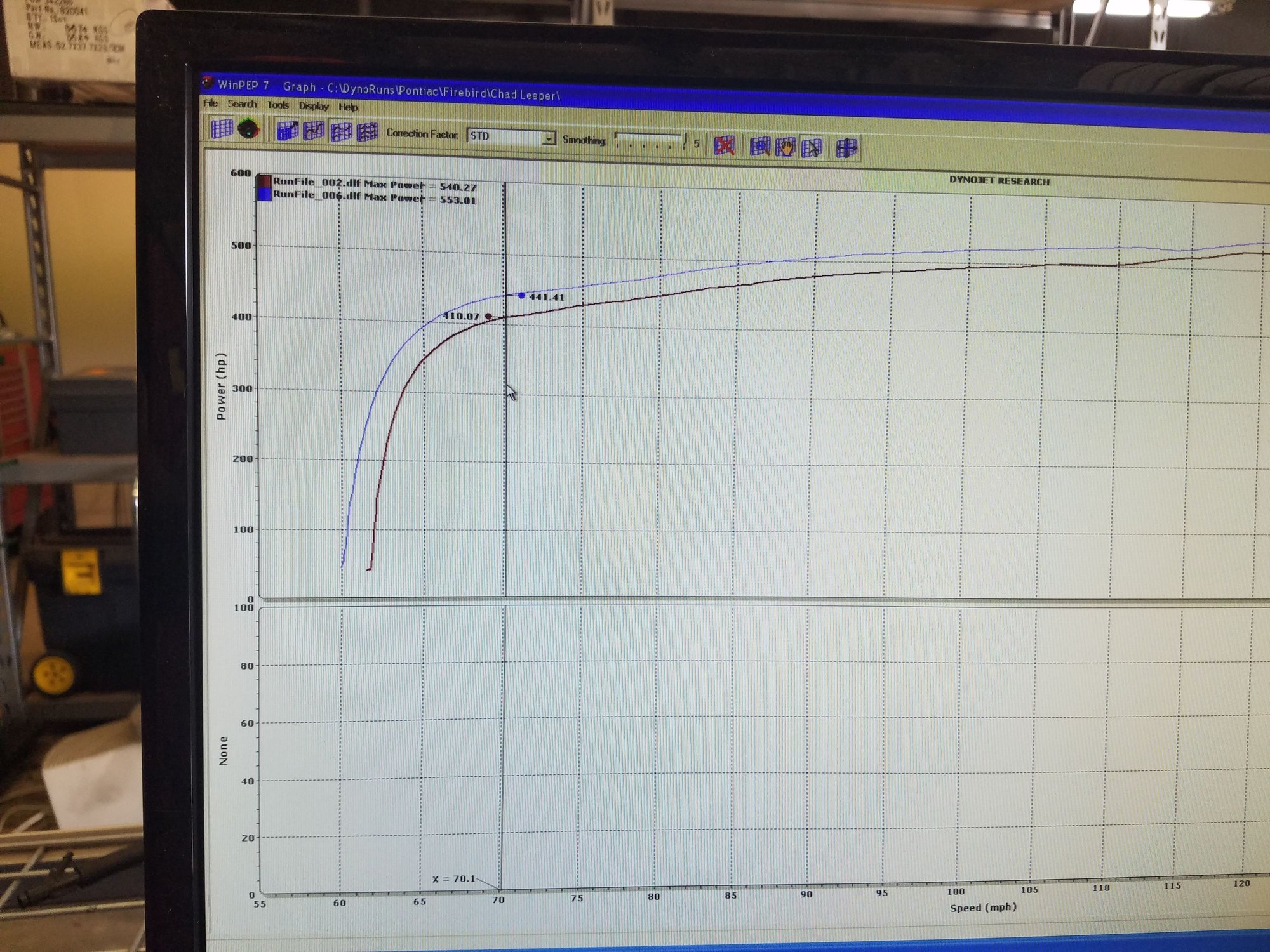

Low lash solids pull forever but seems your car is doing better than a dyno number shows. I originally hoped my 427 would do 600rwhp through an automatic. Reality is 553 but will fry the drag radials from 70mph roll in 2nd.
Dyno is a tool,dont be to caught up on the final number.
This dyno is to show low lash stability with same rockers and springs you currently have.
Your cam choices both bigger than mine too.
Mine is 246/262@.050. .689/.672 112+4. Pull ended at 7600 still going up.
