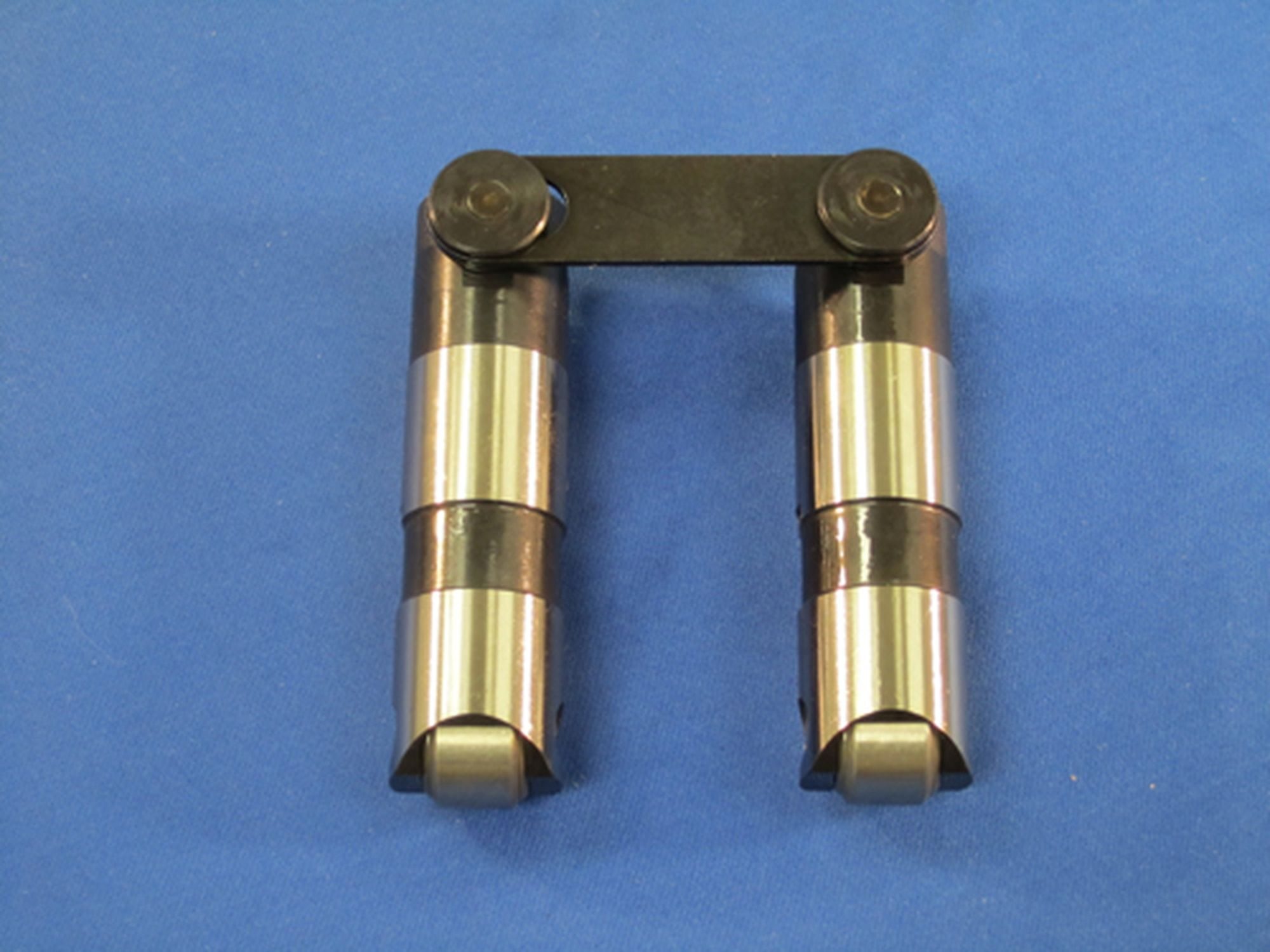

I have a current set of Isky HPX short travel hydraulic tie bar lifters too and the look very similar to those.
Also made by Johnson's.
I need to find out more information about those bushed lifters though.
Part number is 6177BUSH.
I think they are a cheaper version of morel 6177 but have lower open and seat pressure requirements.

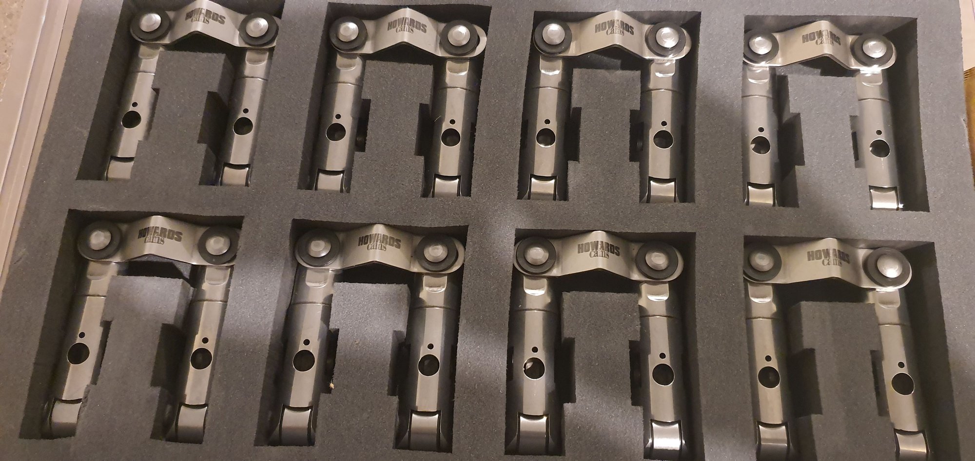

I ended up ordering lifters.
I contacted Cam motion and they told me that their axle oiled lifter that is $782 is indeed a rebranded Morel 5425.
The Howard's Pro max are also the same lifter too.
Because there was a brand new set quite cheap with the ebay special I jumped on it in time.
I had two minutes before the special price expired.
$90 saving so I'm happy.
So glad that is sorted.
I have been doing a ton of research and deciding which ones to get.
Now I can rest.
Old Oct 10, 2019 | 08:38 AM
  #408
bortous's Avatar
Joined: Sep 2010
Posts: 2,898
Likes: 467
Here are these beauties. They came in two days. Just waiting on the LLSR now.

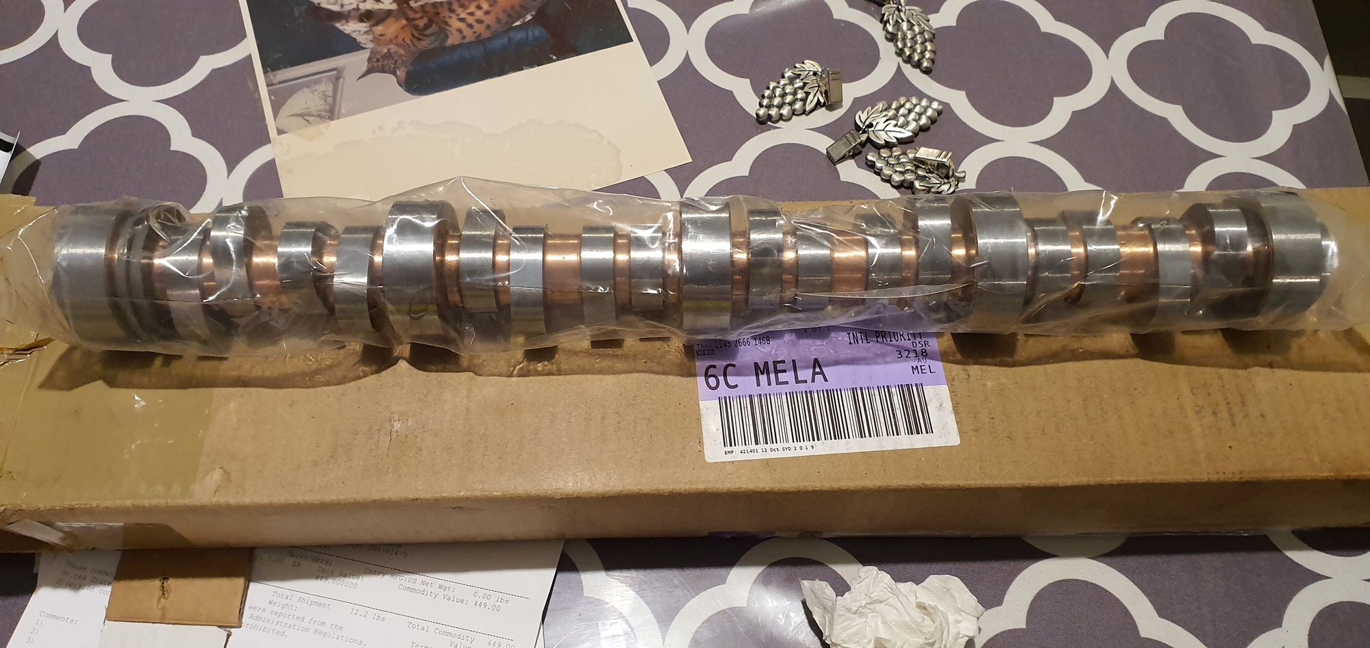

Camshaft was sent yesterday via fedex international priority.
Will be here on Monday so it will be Sunday to you guys in the USA due to the time difference.
Will post some pics up to get you all excited.
Old Oct 14, 2019 | 07:52 AM
  #410
bortous's Avatar
Joined: Sep 2010
Posts: 2,898
Likes: 467

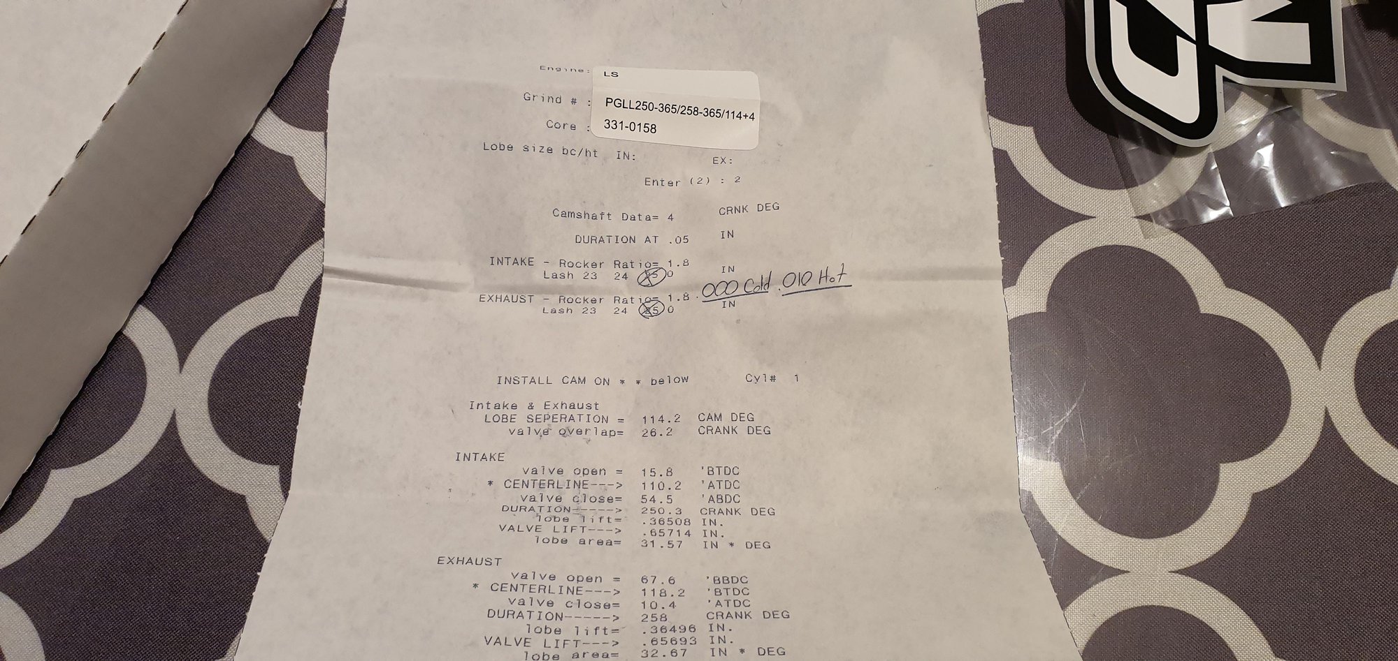

The camshaft arrived and what a beauty it is. Erection inducing material.
It was ground perfectly and as described.
Here's hoping that these Pat G custom solid roller lobes work their magic like last time.
I admit I did ask why he specified me a camshaft with only an 8 degree split for my combo and he had some very valid reasons.

Splits are just a result of the math. Like LSA, advance, and everything else. Only the valve events matter.
That's true because Patrick still got an ivc of 52 and Evo of 64 with only an 8 degree split vs 15 what I had before with my 242/257 113 LSA +3 hydrauilc spec.
He also said with an 8 degree split you will make more low and mid range torque as well as more under the curve too. Probably even a higher peak torque number too if I remember correctly.
