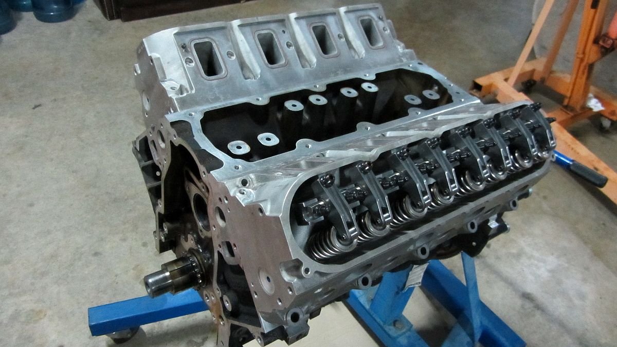

I have T&D steel roller rockers (pic of them below I took earlier in the year). The lifters I still haven't bought, thinking I can get away with the Isky solids that use factory lifter buckets that I mentioned to you earlier in this thread. These heads don't need overly heavy springs with that cam as the heads have 2.100" titanium 7mm stem intake valves (very light) so thinking it won't murder those lifters too much. The lifters are just about the last thing I need to decide on and then measure for pushrod length.
Nice looking build man.
Nice and clean.
I want to make love to that intake port.
If you are running a solid cam don't skimp on lifters.
Buy the best ones you can afford.
Cam motion and another member on here told me the same thing.
Needle bearing lifters can fail suddenly.
Which is why Buy the best ones you can.
If you have the money go bushed.
