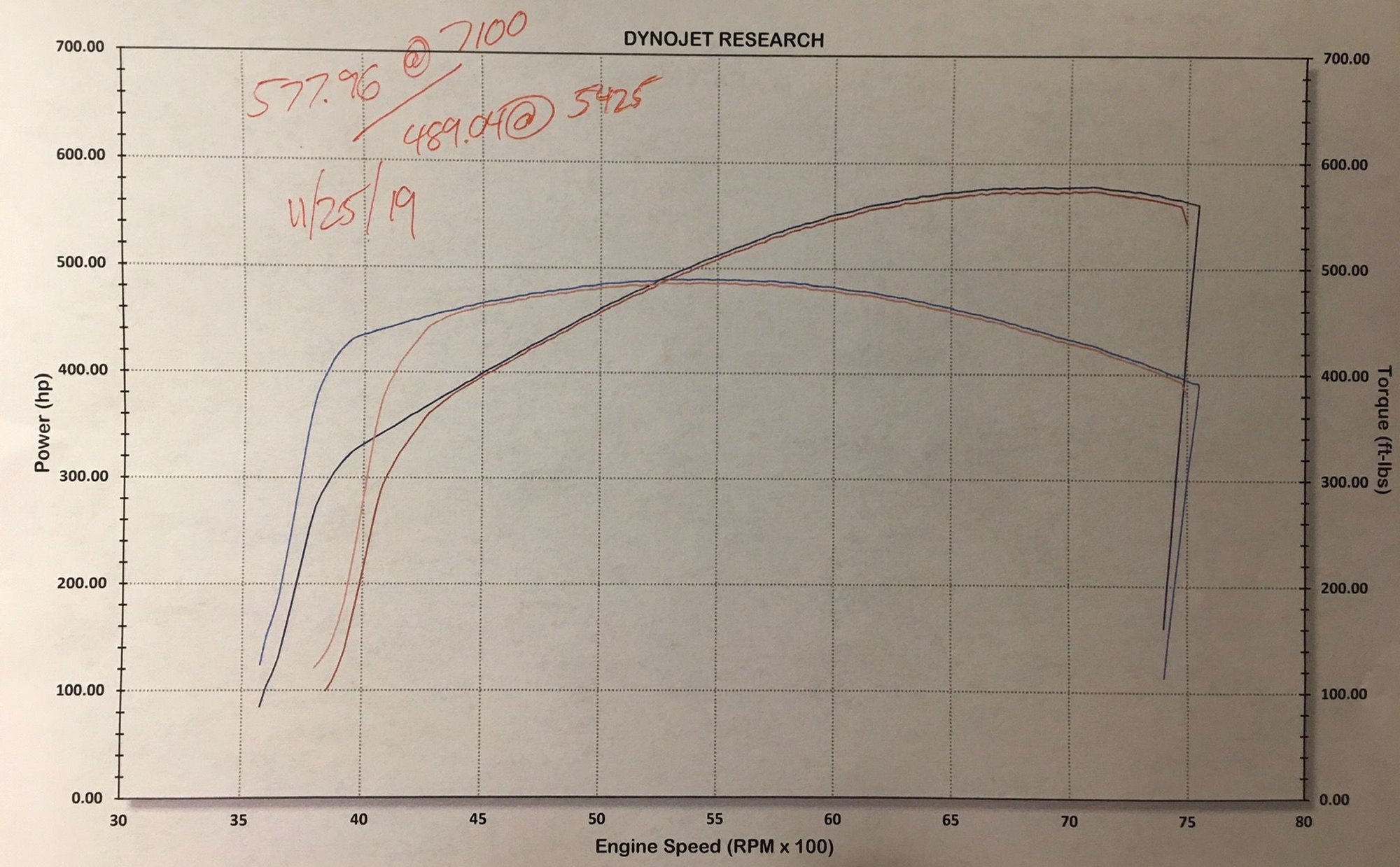

I actually jumped off the PAC1209 and moved to the Manley Nextek 221421 springs. seat is 165, open is 515. My intake valves are Titanium and lighter than stock LS1, so I think I'll be OK. Plus the retainer hardware is also Titanium. Tony and I picked them out together.
I dynoed to get a baseline. I haven't posted it yet, because I'm honestly disappointed in it, but I will. I kind of wanted to get Tony's take on it first. You'll see it is very stable. Kind of anemic for what it is though. I'll post up something more detailed later. As it sits currently, It's running BTR Dual Plats on heavier valves and not floating at all. That's stock rockers and lower lift, though, so i see your point...
Oh what's it doing and the baseline is low?
Could it be that the tune is out of whack?
Not likely a tuning issue. Just based on trap and weight I expected a higher number is all. 134 mph and 3460 race wt. AFR steady at 12.7-13.1. 13.3 at the very top
I was disappointed in my numbers as well...still am, but I know that tuning will net me better numbers, (that’s where you’ll come in Jacob, if I ever find the time) being as my initial 5 pull measly dyno session was done without a real wideband. But then I came to the realization that my car will spin 4th gear, so I don’t really care what the dyno said. It drives great and is WAY more power than I can ever use except to maybe get a set of handcuffs put on me. Last time I drove the car I was doing 118 in 4th gear and didn’t realize it...just stupid.
I contacted Tony to share my numbers with him after my hour long dyno session last year...wow it’s been over a year...and he couldn’t believe we were done so fast. Explained the wideband issue, which explained the “only” 616 hp. Told him I’d get my wideband going and get back but it’s been 15 months now and I still haven’t been back. Busy busy.
I hear you. And I know it's just a tool. But also, I was expecting a 6 to the be first digit. I'm pretty sure the sniper is the problem. Small plenum and short runners, but it doesn't act like a single plane at all. You'll see what I mean on the torque curve. I think it just needs longer runners and a bigger plenum.

Here is the dyno I've been unimpressed with, but I'm kind of over it now. it's a baseline and the heads are coming off, so it is what it is. These LPE660 heads are suppose to be good for 660 FWHP, and they did that easily enough. I just expected it was higher based on how it ran is all. For a solid roller, it's a pretty good torque curve. Power is smooth, valvetrain is nice and stable. Really nothing to be too upset about. But only 40 more HP than my 346, so I think that's what's bugging me the most. Figures are SAE.

If you was on the qtp tires,those numbers are down some for the sake of not spinning. A good drag radial would help those numbers.
Now, this car ran 10.0 at 134 with less than 600@the tires, you gonna really move with the new set up.

Yes the QTP were on for this dyno. 10.1. No cheating. Lol
so throw that msd in the mix before swapping heads and tune it. See what it does for air flow numbers

That's exactly right, which is why I came to the conclusion my heads were the linch pin here. What finally convinced me was that eggcrate thread, where Tony had ported stock castings vs his aftermarket heads with pretty big gains for what it was. Now, I do think jumping the cam from 248/255 to 256/270 AND .650 lift to .750 lift is going to also make some difference. I aimed a little high, because I also think that the longer runners and higher velocity of the heads combined is going to mechanically tame the cam by bringing the power peak to a lower RPM. So I aimed higher on the cam to compensate and keep the peak up around 7K. I won't be surprised if it still ends up lower than it is now.
But I am convinced the sniper is not all that it was cracked up to be.
