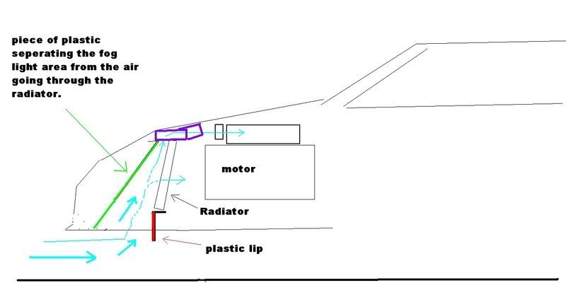

I think Merv is correct about where the air comes from... It hits the lip under the car and goes up in front of the radiator/condenser. normal Lt1s just have the shroud covering the top and all the air is forced through the radiator/condenser. the LS1 conversion lets it come through the top part into the lid straigh to the intake. I have seen something where someone covered some of the radiator with piece of sheet metal to force more air up through the top vs. through the rad. Either way, the faster you go, the more air gets pushed through. forgive the retard pic but here's a MS paint sketch of how mine looks and I'm assuming unless you guys removed pieces a stock camaro should have these parts somewhat like I've drawn....
Close bro..this is how mine is setup.. a little more indepth than some of you guys..but it works good.
I used your pic..
This is how the Car looks..

Yea..heat rises when you are sitting still..
So basically you are saying that when you are moving and the Air deflects off of the Air Dam that is INFRONT of the SLANTED Radiator that it's hot Air from the Radiator..?
Yea...I'm not buyin that one..expecially how I have mine..

After all the brain damage I got about my sealed to the hood ram air box having NO advantage over a CAI.....you are gonna tell me that the air deflector under the car pushes up enough air to have an affect on ANYTHING? COme on dude.
Run you car down the interstate, pop the hood and put you hand on ANYTHING near the radiator...hot aint it? If you look at a STOCK LS1 setup, the bottom of the box is isolated from the radiator/condenser.
These guys that cut a damn hole in the core support and set the filter on TOP of the radiator and condenser have got to be crazy if they think that is helping the car.
But I tell ya what, you go on thinking that it is the best mod since glass packs.

I made a little piece of metal on the back of the Lid, and bent the Radiator top pieces to fit it in. It's secured in the front by a couple Bolts. The Stainless pieces on the side hold the Radiator up in place.
Actually..mine is cold..all around it.
We can go back and forth all day with this..your experiences aren't the same as everyone elses, and the same could be said for me as well.
