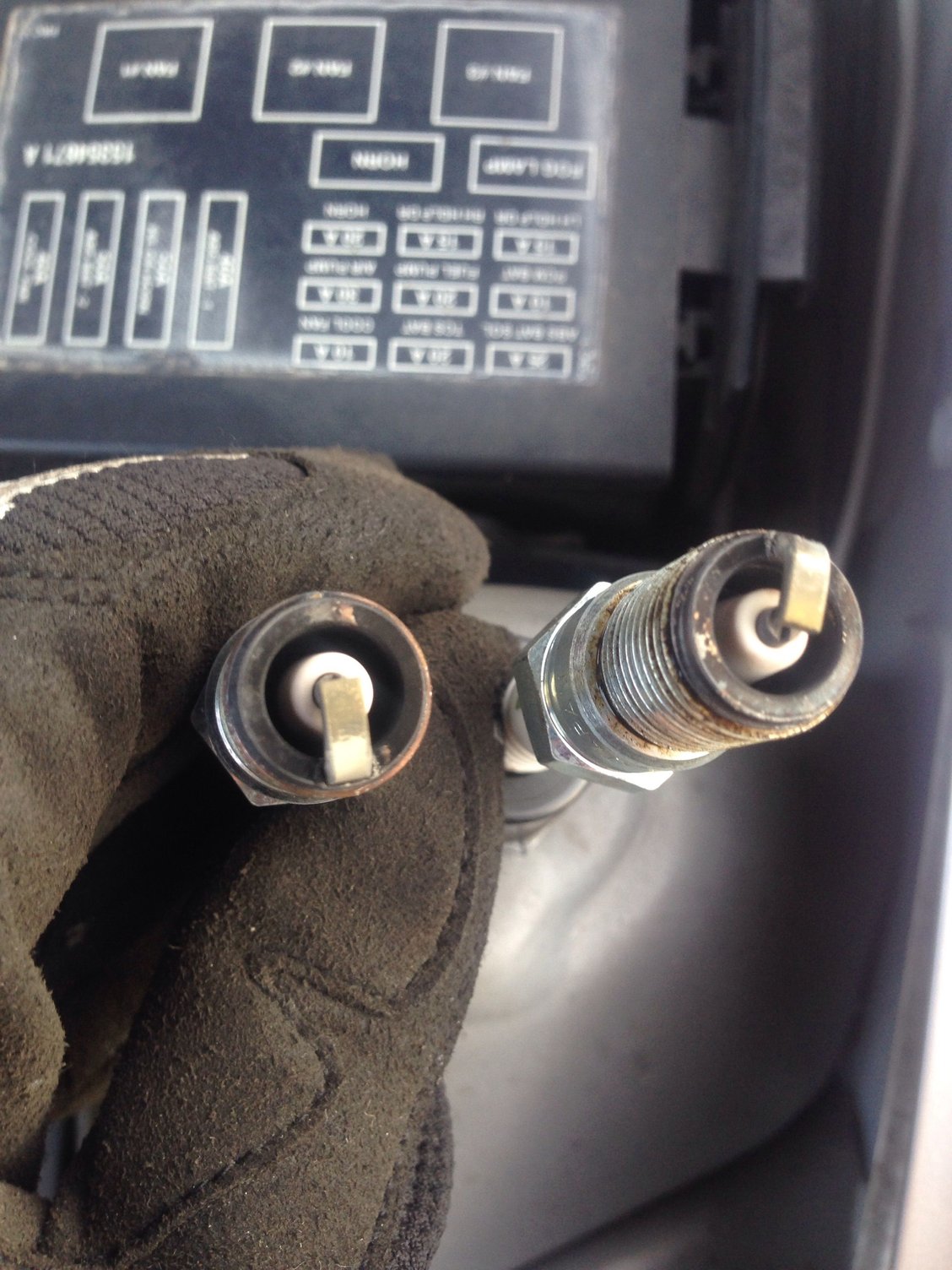

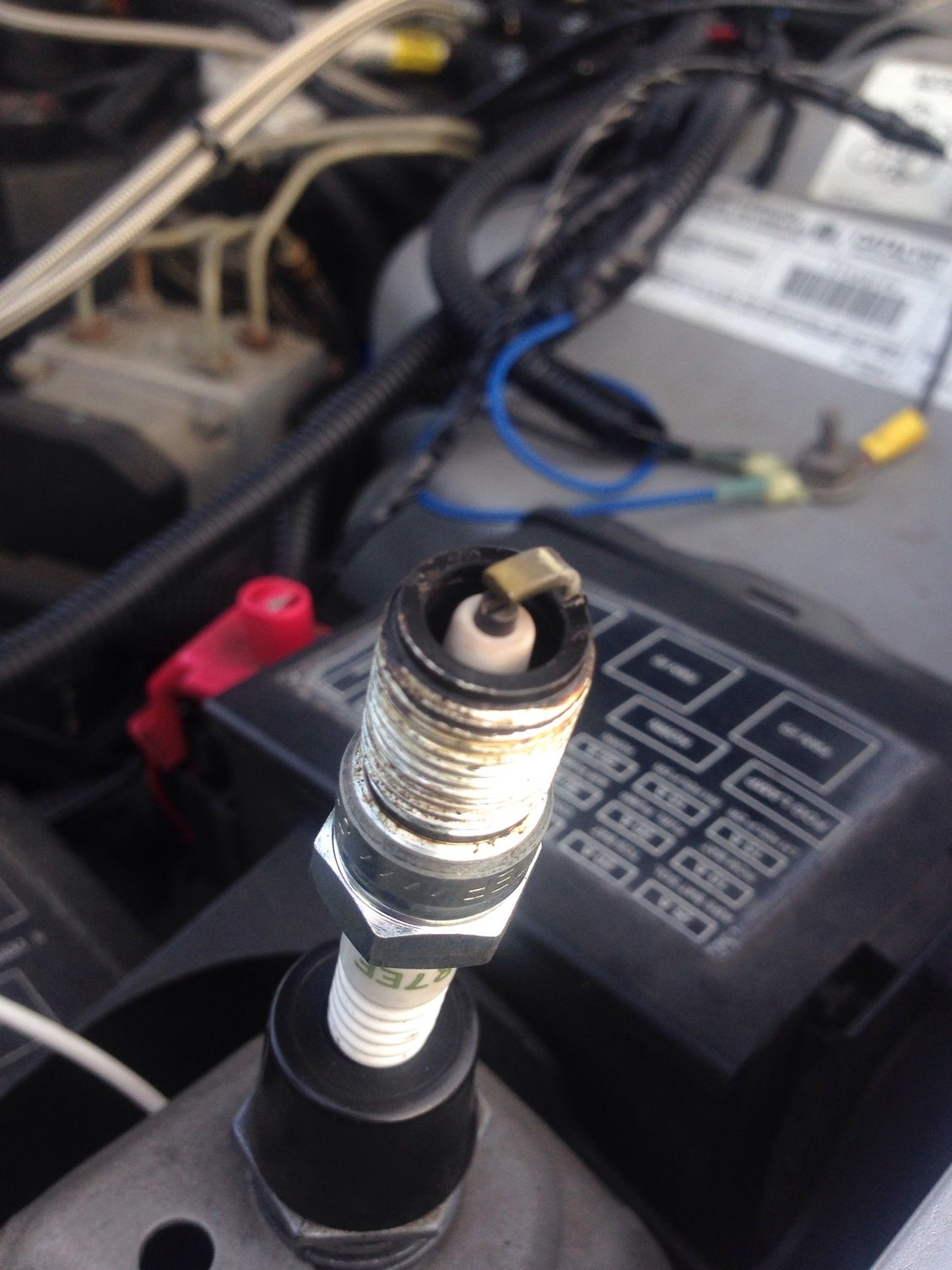

Old Jul 29, 2015 | 06:16 PM
Canderson1434's Avatar
Joined: May 2015
Posts: 44
From: Whitehall, PA
This is what pretty much all the plugs look like i changed the jets from the 150 shots to the 100 shot jets with the ~2 degrees timing af based off my oxygen sensors was really rich. I'm not good at reading plugs any input would be help me
Old Jul 30, 2015 | 09:29 AM
NitrousExpress's Avatar
Ls1tech & Truck Sponsor
Joined: Jun 2010
Posts: 2,267
From: Wichita falls Texas
The timing mark needs to be right around the bend, which it looks like it is in the pic, and you want to tune to a really light brown color. If they come out black or sooty, that's obviously rich, and if they are white they are too hot, which could be from lean condition and also too much timing. If you have too much timing you will normally melt the plug, burn off a strap, or if the plug is too cold for your application you could melt a piston.
2* per 50hp is a very good starting point that will be very safe.
You can tell alot more about the plug as far as fueling goes, by cutting off the threads and looking at the fuel ring thats down inside around the base.
-Garrett
Old Jul 30, 2015 | 03:02 PM
brandon@nitrousoutlet's Avatar
FormerVendor
Joined: Feb 2013
Posts: 1,479
Likes: 21
From: Waco, TX
How far did you drive on these plugs?
Old Jul 30, 2015 | 04:38 PM
Joined: May 2015
Posts: 44
From: Whitehall, PA
I sprayed on them from 2nd to 4th so probably about a 1/4 mile
Old Jul 30, 2015 | 04:39 PM
Joined: May 2015
Posts: 44
From: Whitehall, PA
-Garrett
Would you advance timing to get closer to the bend or retard it?
Old Jul 31, 2015 | 10:19 AM
FormerVendor
Joined: Feb 2013
Posts: 1,479
Likes: 21
From: Waco, TX
Man, that plug really looks like it's been driven on. You can see part throttle fueling on it. Was the plug brand new when you did this? The plug needs to be new, have little to no idle time on it and once the pull is over, the car needs to be clicked off immediately. This is the only way to get a correct reading. Is that what you did here?
Old Jul 31, 2015 | 10:50 AM
Joined: Jun 2010
Posts: 2,267
Closer to the threads means it has too much timing, close to the tip means not enough timing.
-Garrett
