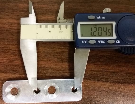

My problem is that the car is not going full throttle after installing the NOS plate kit due to cable is not fully extended .I tried to move the OEM bracket forward but then Idle won't be accurate .Long story short the cable either not fully extended or not fully retracted. I lost the Throttle Cable Extension bracket which came with NOS Kit .As per Summit racing P/N 49R2095 discontinued. I'm trying to find anything that could help my case or any dimensions to fabricate it locally .Any alternative solution ?

Hope this helps

That's great help Chris .Can you send me the holes location and dimensions if possible .I know I'm to greedy .Are you selling this particular piece ?

Counter sunk hole bolts; M6-1.0 x 10
The other holes you'll reuse the factory bolts.

So we are talking about 0.79 in of shifting from the original position.
