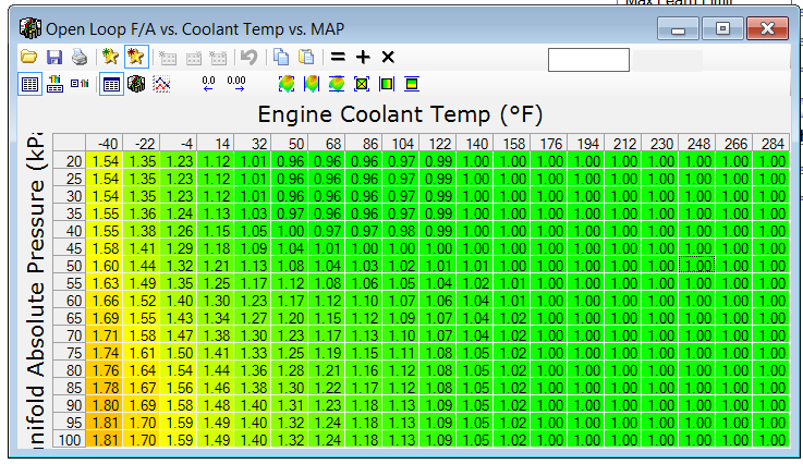

It almost seems like it can't burn the fuel effectively at cold temperatures. Here is my O/L EQ table settings. I have it so it runs richer at colder temps. Should I try leaning it out? As it warms to 160+ it idles out fine. I run around 70 kPa with my cam.

I'd try peeling back the EQ table enrichment but also
put some time into your cranking-VE table, which can
go neglected but needs a lot of help with a big cam.
You get a double whammy with both the VE being way
lower than table post-cam (so aim rich) and the high
cranking MAP (EQ table enrichment). There's no real
good way I know of to adjust the cranking table, other
than stitching the two together in Excel and trying to
fit the VE vs RPM trend at the low end, by eye and by
outcome (which outcome, can only be had over a bunch
of cold start cycles - tedious).

Thanks, Jimmy. I hadn't really messed with the cranking VE. But it was definitely way off from the VE table. I just manually massaged it and took about 5% off the EQ table enrichment in the lower temps. I'll see how that does.
