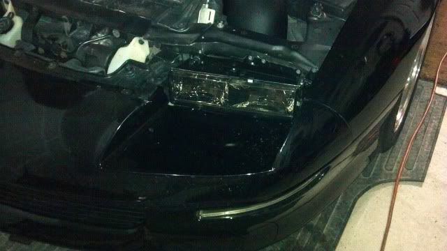

I didnt contact Founders, I believe they sell a bolt kit optionally, I purchased them for the control arms and didnt think about the panhard bar. The factory bolt is actually two sizes and the portion closer to the head is larger than the hole in the misalignment spacer. You could probably drill the one out to match, I just didnt want to mess with it...
I purchased 88-98' C/K truck headlights and will be installing those in place of the sealed beam crap. I did the same mod on my 95' and loved it.

Oh damn...that looks cool as hell! :-D Much of a modification to install the C/K lights? Or was it pretty much bolt on?

Agreed, I really like how they look being all one piece/smooth. You have to cut down the bracket and retaining bolts on the actual headlights. Then you have to cut out the stock headlight mounting points/bracket on each side and it's best to cut the bumper so the headlights can be as low as possible for hood clearance.

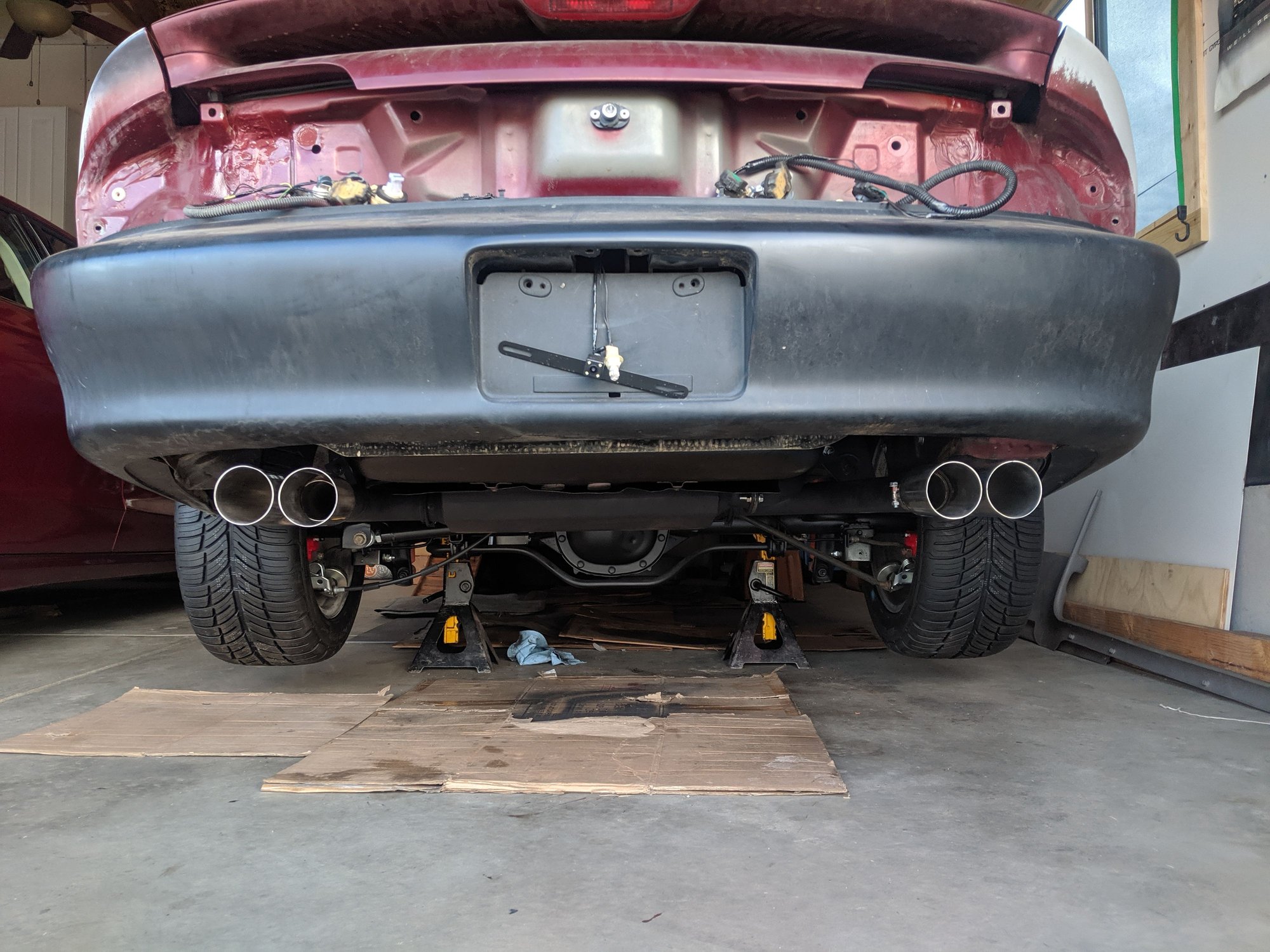

I am almost finished with the cat back exhaust system, I have everything in place and tightened down up to the tips. I decided to leave them loose for now, I need to pull the bumper cover for paint and they block two of the fasteners. Ha Ha

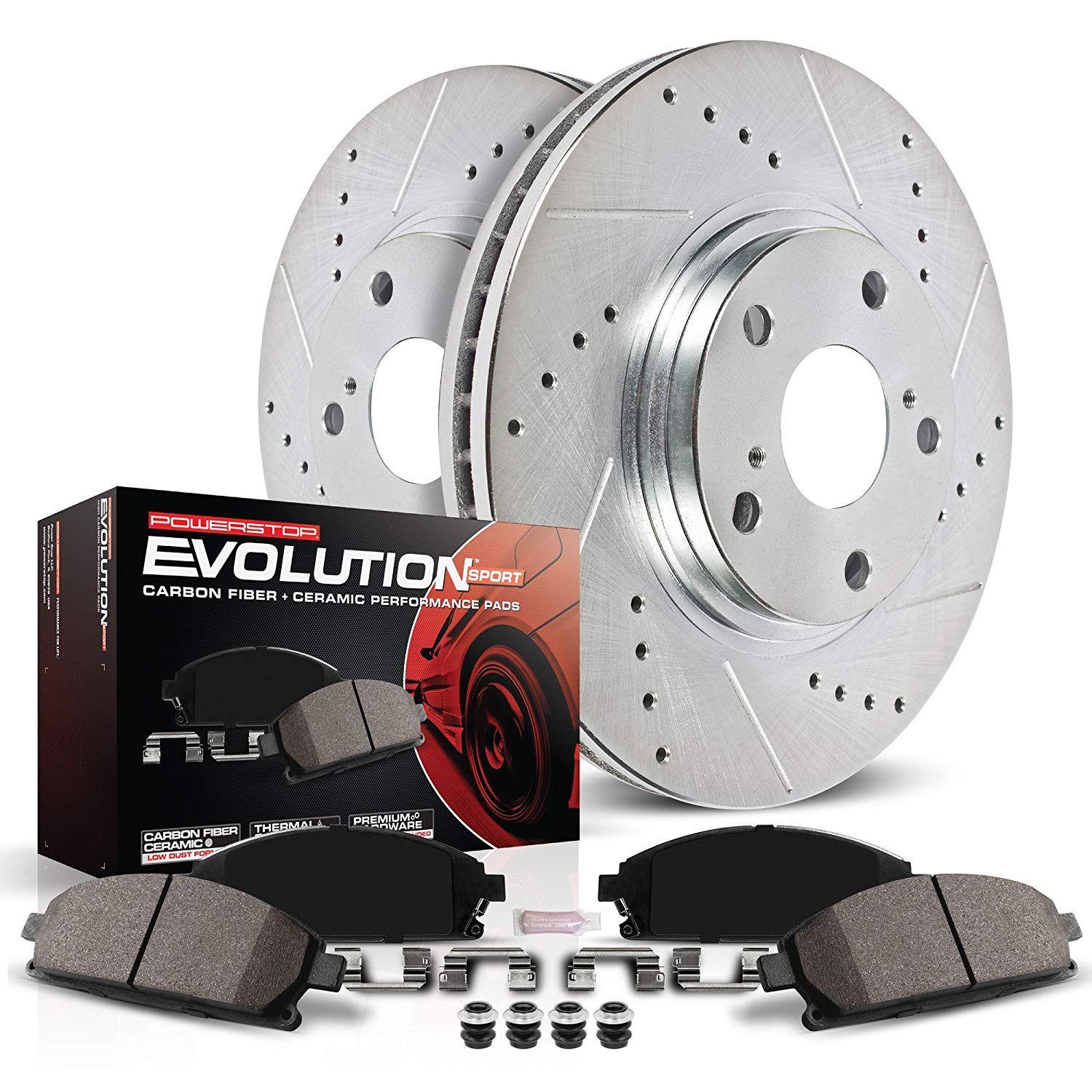

Ordered the PowerStop front brake kit, which is slotted/drilled rotors and ceramic pads to match the rear. I will just paint the OE calipers and brackets for now to also match the rear. I plan on going to C5/6 front brakes after I can afford to upgrade the wheels.
