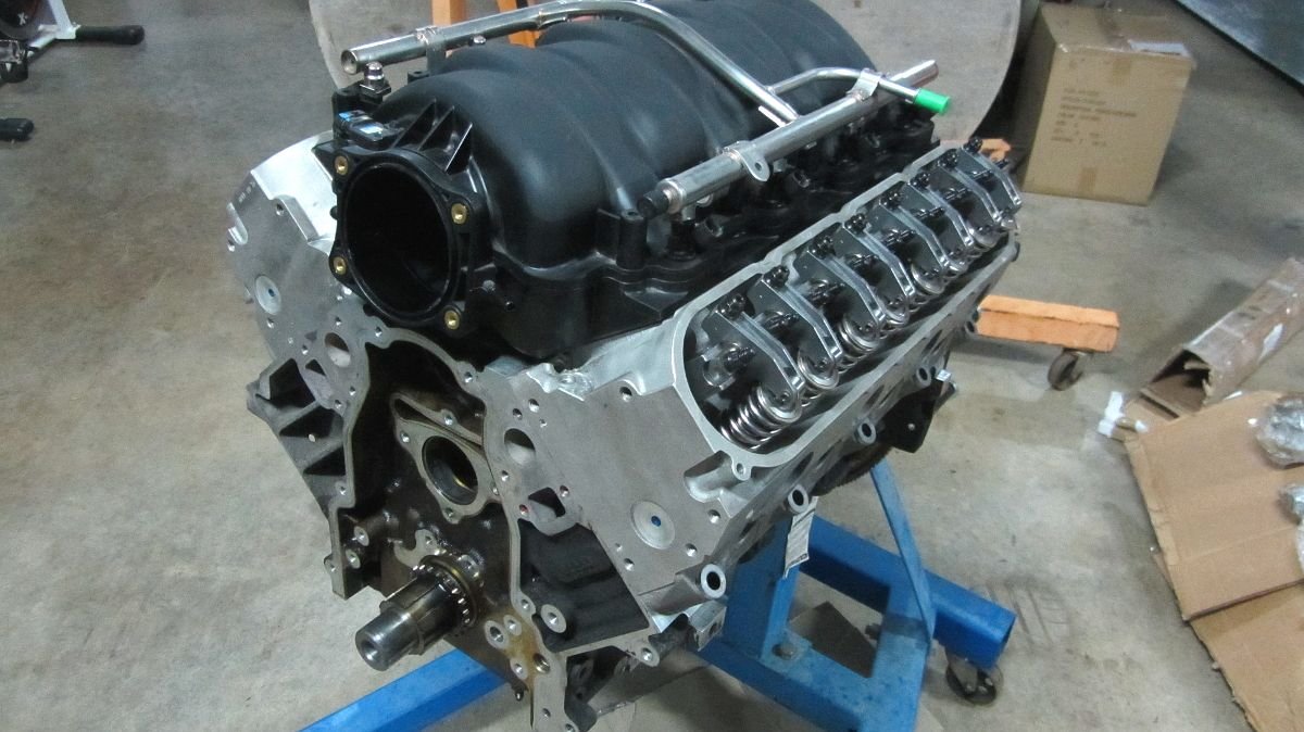

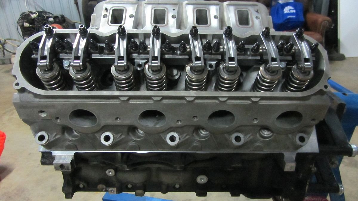

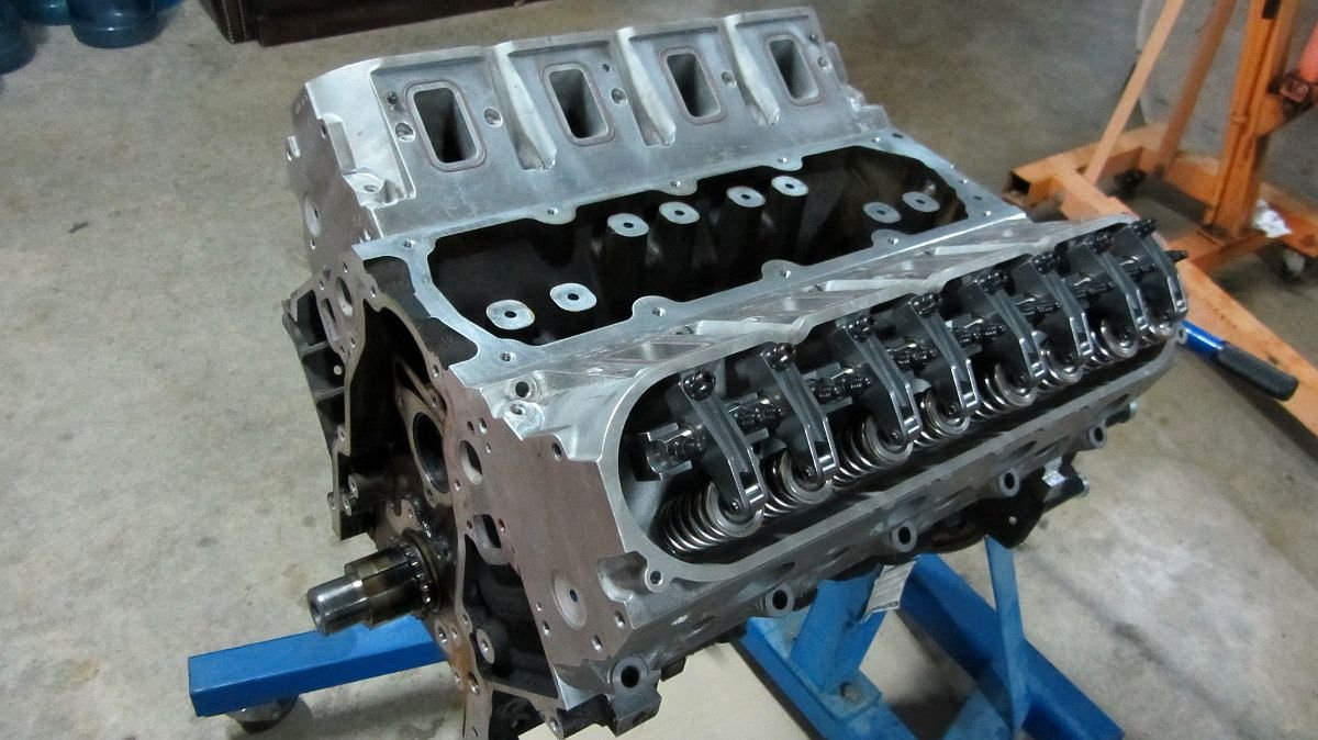

Old Dec 22, 2019 | 12:14 AM
  #730
Launch's Avatar
Joined: Jan 2003
Posts: 1,000
Likes: 134
Originally Posted by bortous
Because of this experience I am not going to touch Morel solid lifters again for any build unless I have an aftermarket block.
Me neither. Except for the drop-in style that use the factory buckets. But now I'm wondering if I should even trust those or quit while I'm still ahead and buy crowers with axle oiling. Because a local ebay seller just got some stock in of them. $1500. When ebay offers another discount I have to have a good think about it. I don't want to go to all that effort to swap out my current engine and end up with a turd. If it's going to go down like that, I may as well just throw some good cnc cathedrals and fast intake/102 on the current ls1 in my Camaro and have fun with it.
Ah the good old LS2.
Are you using the stock heads?
Small bore ls7's. I should have my own build thread but I take so long to get it finished I'd bore everyone to death. This is my engine taken earlier in the year..
Old Dec 22, 2019 | 01:10 AM
  #731
bortous's Avatar
Joined: Sep 2010
Posts: 2,898
Likes: 467
Very good heads.
If you want it to drive well etc you can't really go max effort because you will need lots of overlap.
I would probably go somewhere in the middle so you get decent driving manners.
That also looks like a GM LS7 intake.
I'm not sure how that would go on an LS2 block.
I would have Pat G or Ed curtis spec you a camshaft for your build.
In regards to E85 be aware that your fuel economy will become 35% worse.
Not an issue if this vehicle is a weekender.
You will make a bit more torque and hp if compression is high enough.
Gains aren't that big on NA setups.
Forced induction different story.
