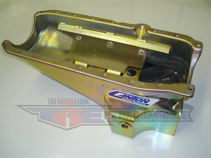

I did a search on cz28.com before I put it in and people said it was designed to work without the windage tray, and it wouldn't fit over mine so I took it out. Looking back that was probably my mistake,.
maybe you are foaming the oil due to lack of windage tray...and OP drops.
Does canton offer a windage tray for that pan?
My $02 is run a windage tray on whatever pan you use.
It has a windage tray built in. With the way the pan is designed I don't believe the stock windage tray will fit.
Correct, best pic I could find with a quick search.
