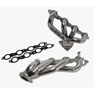

Just curious, after looking at my '99 F-body manifolds today and pondering while i had nothing better to do. Will a set of F-body shorties fit our trucks? I cant imagine they would be too far off, maybe fit with a little persuasion?
Anyone tried it? Sorry if its been discussed, i cant remeber everything in this thread.

I bet they will. the header maybe a little thicker. (as far as distance away from the head)

This is a set of BBK shorties with 1-3/4" primaries. The tubes look like they tuck pretty tight for steering shaft clearance, and clearance isn't much of an issue on the passenger side, as long as the flange clears the firewall and leaves room to route a pipe off it....i think it may work.
These edelbrocks with 1-5/8" primaries look like the tuck pretty tight too. You may have to hack off the flange on them and weld an extension like on the stock manifolds..but for the bigger primaries, it may be worth it.

for the price to try the f-body headers you can get the sanderson shorty ls1/s-10 headers for $225, they fit very good and come with collectors

i agree, but alot of people complain of the small 1.5" primaries.
