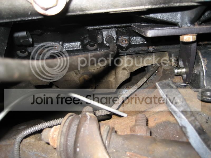

Dropped the motor in to check for pan/crossmember clearance. I made the the notch the same as others ive seen online (2" x 10"), and its way bigger than it needs to be. Just thought it was interesting, and that it might save other from cutting so much out. My motor sits as far forward as the mounts allow too.
was there any notching in the first picture?? what pan did you use? i'm still debating on usin the ls2 pan or the h3 pan
Yes, they were all taken at the same time, i didn't notch the top of the crossmember though. Their is more room between the pan and the crossmember then it looks in that first pic too. Its a stock 5.3 truck pan.

I thought about it for a while and even tried swapping them and it was nowhere near close to fitting, i do think its a little weird that its all the way forward in the slots but it fits nice, their is no room to slide it back though and take advantage of the slots. I put them the same was as i saw others were set up in this thread. One is short and one is longer, these lined up nice and the motor is level, i dont think it would be if they were backwards.
